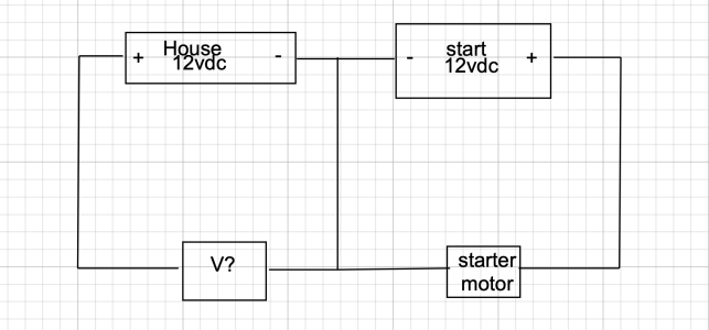

The vertical line in the middle is shared between both. There is voltage drop across that wire that is equal in both circuits.
Redraw the diagram with that wire replaced by a resistor and it might make more sense to you
You are confusing current and voltage.

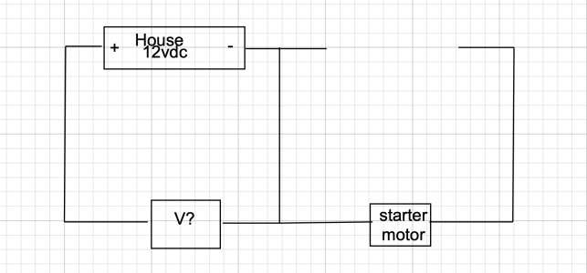

Nope. I don't need to. Show me how the load of the starter motor effects the house battery voltage.
You do need to because you clearly haven't understood.
This has nothing to do with the house battery voltage (I am really not sure where that idea came from - I certainly didn't suggest it) - it has to do with the voltage drop in the circuit. That is why you should draw a resistor - it might help you see that rather than getting all confused about mythical drops in the EMF of the battery
You really do because Ive just removed the start battery so you can show me how the "voltage drop" in the negative lead will change for the house circuit?
How can these two circuits run at different voltages when they share a wire? Does that wire know where the electrons came from and run down a different lane like a motorway?
The circuit voltage is the tension across the battery. The two circuits can and do operate at different voltages as everyone who has a boat with two circuits knows. Otherwise we would always see the same voltage on both batteries with common negatives.
My apologies - I meant potential difference - ie voltage drop - across the common wire.
Imagine a poor joint in this line. At 1 or 2 amps this may not be apparent to the instruments, but suddenly chuck 300A say down it - what then? The potential difference (voltage drop) suddenly gets substantially higher - and the argument presented it that this has to affect both circuits. Hard to see why this would not be the case. I would like to see the maths.
The resistance of the wire doesn't change with current flow. It will change slightly with heat but that is self regulating as the current will drop as the resistance increases until it burns. This is not applicable to the case in point. The effect of the starter motor current will not change the resistance and therefore not effect the load in the house circuit. It will not cause a voltage drop in the house circuit. That will only happen if there is an increase in current in the house circuit i.e. it is feeding the starter. for this to happen the positive of the house battery must be connected in some way to the positive of the starter and the probable cause is the VSR in the OP's case.
