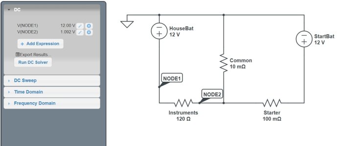

Well there you go...What this simulation shows is that the voltage of the ground side of the house load does rise significantly with respect to the ground of the house battery at the battery (1.092 V) and consequently the voltage across the house load drops.

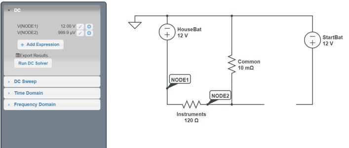

#106 gives concrete figures that prove what I have been saying.

Any common cable in the negative connections to both batteries will cause the negative in one battery to rise to a slightly positive voltage with respect to the junction of the negatives thereby reducing the voltage available.

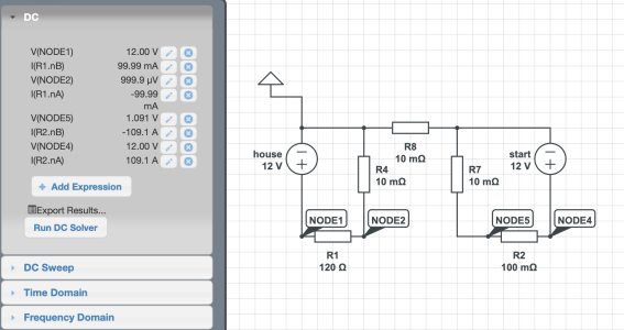

so just for fun here is what it looks like with a shared neg but individual returns on each circuit:
