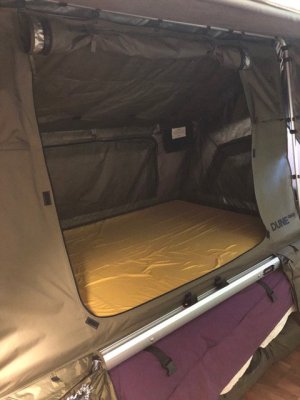

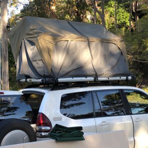

I believe the inflatable tent, or the tent supported by inflatable tubes, was developed by Vango who were, still are, a Scots company established 1966. Their major competitor must have been Blacks and Millets. The idea that inflatable tubes for a tent is an Australian idea needs some polishing. However the Roof Top Tent, one that sits on a car (or 4x4) roof rack, I believe is an Australian/South African idea, they open up like an old fashioned pram, and could be developed to 'become' a cockpit tent (if the market we're large enough to support the development). The frame might be a challenge to store.
This our RTT, opened up indoors. Its 2m long by 140cm wide. The second picture shows it installed, properly.
They are now custom made for specific vehicles, say Defender.
