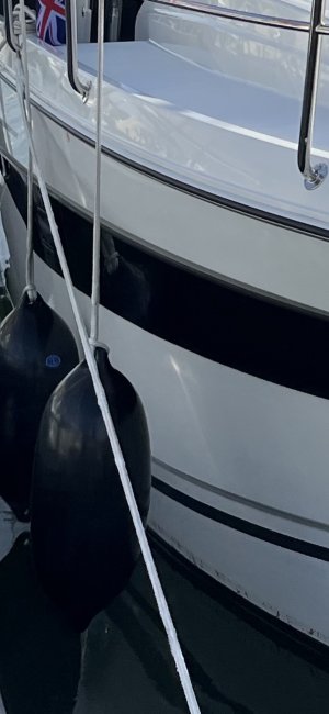

Found a picture where if you look closely you can see the sealant on top of the glass.
The glass is in 2 pieces with the joint by the nearest fender

Ah ok thanks.
The "two pieces" thing is a red herring.
That looks like fritted glass (ceramic printed fritting) and will be bonded onto the GRP flange using a polymer/polyurethane. My weapon of choice for fixing the glass onto such a GRP flange would be Sabatack 750xl (with primer 9910 on the gelcoat), but there are plenty of competitor products. Sabatack has been used by many boatbuilders and I have owned boats for 10 years from new with this product, and had zero problems, in sunny climates (Med).
As for trimming/sealing, as distinct from adhesion, I would use the same product and I believe most builders do, where it is needed (it usually isn't). I have had Sabatack exposed to sun on a slanting transom window, with a 4mm fillet of Sabatack around the edge of the glass exposed to the sun for 9 years with zero problems.
However, it looks from your photo that, consistent with how most builders do it, there is no sealing fillet along the horizontal top/bottom edges of the glass. Instead. it looks to me like there is a just an adhesion bead of glue that is mostly protected from the sun by the fritting and by being in a recess, but the top edge of the glue bead gets some sun. That product will be an adhesive not a mere sealant and I would use Sabatack for patching that.
In contrast, if you wanted only to repair a sun-exposed vertical sealing line between the two pieces of glass where they abut, then any black polyurethane would also be fine for example Sika 295UV or 291iUV

Thanks jmf the vertical joint between the 2 the sealant is coming out and needs replacing, the horizontal seal on the top of the glass has a small split in it.I will re seal the vertical joint with the sika 295 or 291 and monitor the horizontal seal .👍
