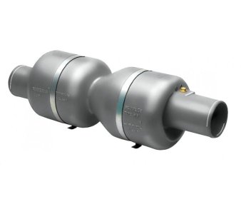

Something like this?
Vetus MV150 Plastic Exhaust Muffler with Check Valve (152mm Diameter) 410208

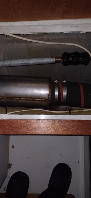

i have attached a photo of the existing silencer. The exhaust pipe comes off the engine down to this silencer and then straight out the back of the boat. The silencer is below the water line so full of water always.

Finally got the silencer out of the boat after a good five hours of fighting with it in tight spaces. Got it home cleaned it all off and filled it with water. Yes one of the welds has a small leak - the bit that's leaking looks as though it was a bit added on when it was made. However hopefully i can get it repaired as the rest looks ok. My question now is - i had to cut the hose to get the silencer out. The silencer tails are 99/100mm diameter but the closest dia. exhaust i can see is 102mm, will this seal up properly with two bolt clamps or where can i get 100mm dia. hose from??
