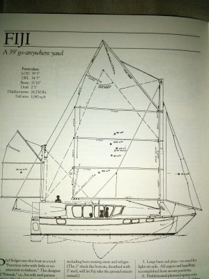

Talk of wheelhouses reminded me of this design by Phil Bolger. The deckhouse contains the galley, helm position (a gimballed seat with a seatbelt), settees and dinette. There's a double cabin forward with a queen-size bed, and a cargo hold aft with a 2,000 litre fuel tank and huge water tanks, sewage holding tank and battery bank. It has a 1" steel plate over most of the bottom so you can ground out on anything, and a centreboard to dry out upright. The mast can be lowered at anchor. The engine can be removed without any carpentry being required. Two rigid dinghies are carried on deck. The rig is large, for light airs, but can be reefed from inside the deckhouse.
Modern cruising boat design has coalesced around a surprisingly small range of hull shapes, rigs and interior layouts. There are lots more possibilities... I'd get one of these built like a shot if I had the money. I'd love to cruise Ireland and Scotland and not be restricted to the summer.

I have always admired Bolger's out-of-the-box thinking and I have a book of his designs somewhere. Alas, having made my living through a degree of aesthetic sensitivity, I find his designs to require, at times and on occasion, too much intellectual effort on my part. In the flesh, I have found some of his boats to be even more awkward than on paper. But beauty, as all such things, appears to be in the eye of the beholder.

Yes - he designed some gorgeous boats, but the ones I find most interesting tend to have forms drawn strictly from function. I like that myself but it's certainly not a universal taste.
