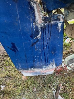

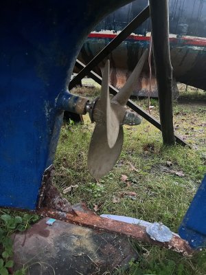

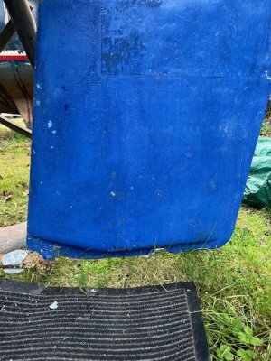

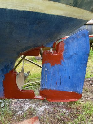

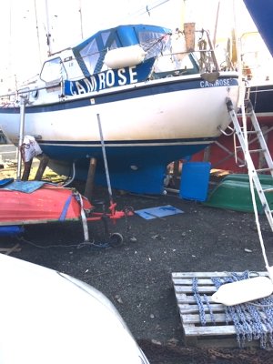

Well Work is comple on my hull and rudder modifications, as per Laminars suggestions.
Annoying weather helm abolished and tiller less than 5 degrees of central position on broad reach. Much like our old non-motor sailer. Probably less than £150 materials and 4 long days resining and waiting for things to harden before sanding or grinding

It was hard to be certain if the upper fin and the fairing in of the rudder was truly necessary, but once I had epoxy, builders foam and filler in my hands it seemed advisable to do the lot.
Sadly didnt have a chance to test the tiller pilot while crossing Wembury Bay last Saturday, but the tiller being in neutralish position makes me very hopeful. The acid test will be crossing the 70 or so miles to Channel Isles and Normandy mid May
