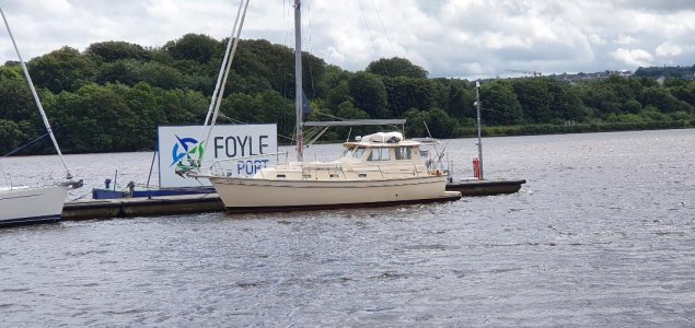

The Island Packet designer, Bob Johnson, added this model to his line up as many American sailors were turning to the 'Dark Side' and buying trawler type motorboats when they found sailing a little too demanding at a more advanced age. I think he got it about right!
Don't gloat, Rotrax! 😄
I reckon Bob Johnson got the design of your boat exactly right, for a far higher proportion of sailors than are prepared to concede the design's advantages.
I'll never afford one but at least I'm not in denial that it's fabulous.

I am trying not to-honest!
She is a great boat, but the annual maintainence is becoming harder every year, so I suspect we will part with her in 2025.
If I have to pay yard bills I cant afford to keep her.
We have recently got a 10 metre berth in our club Marina, 1500 hundred a year.
The IP wont fit, so a smaller vessel will be purchased that will.
