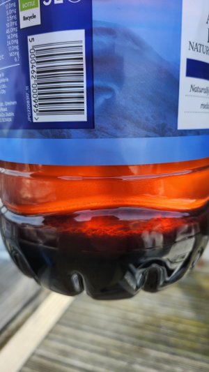

Bit of a long story here but please bear with.
Oh dear... that is a sorry sight.

So what I think must have happened is that when the boat was on land and getting engine swapped out when I was running petrol through the tank and it was coming out clean the gunk was sitting on the bottom of this giving the illusion of a clean tank, then when we took her out to see to seatrail her it brought all the gunk to the surface and clogged the filter... This is my theory anyway.
