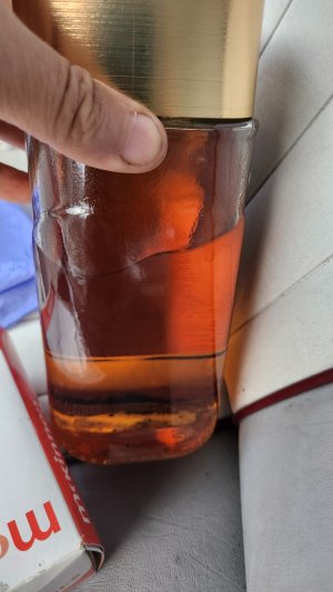

We have a boat which had a diesel engine in, we have swapped this out for a petrol engine. The fuel tank had the diesel pumped out and fresh petrol put in and then pumped out until it ran clean (please see first photo) we the topped her up with more petrol and took her for a sea trial where she promptly cut out and would not start.

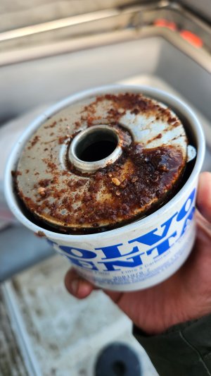

Suspecting a fuel flow issue we checked the filter to see it completely clogged with gunk. (I'm not sure where this has come from or how it was missed when we previously emptied the tank..
Is there any way of flushing the tank properly to Clean it out as I have no idea how much of this sluge is in the tank.
There is no inspection hatch and I'm unable to the get the tank out the boat of the sender out of the tank to have a look inside. Any help or ideas would be greatly appreciated.

Without an inspection hatch, I think you've got a problem. There are companies that will clean fuel tanks, but I think they require better access than a filler can provide - but I'd approach them first. I don't know where you're based but Google is your friend!
The sludge looks like "diesel bug" - that is, a microbial contamination of the fuel; it can live off diesel oil and small amounts of water. It's a well-known problem. There are chemical treatments (e.g. Grotamar, Marine 16) some of which break the "bug" down, but a) I don't know if they'd work in petrol and b) you may have too much contamination!

Thanks for the reply, I'll follow your advice and see if I can find a company and also research whether marine 16 will work in petrol.
Thank you

If you can’t remove the tank to clean every surface and inspect, then the tank will have to be brimmed several times, agitated, drained. Costly! Even then….
Google cleaning car tanks. If it’s steel, it’s probably corroded anyway. Get a petrol outboard tank.

Most additives will work in gasoline ... gasoline is only steps up the fractionation of crude.
What gasoline will do is act like a solvent and dilute the effect of the additive.
The problem now that gasoline has been put in the tank - means risk if wanting to cut an inspection / access hatch. Personally I would empty out the fuel. Then fill tank overflowing with water .... to push out gasoline vapours ...
While STILL full of water - then cut a hatch. A plate and gasket can be easily made up to fit.
Once hatch is made ... pump out the water ... then get a high detergent oil dispersant cleaner in there ....... as its obvious that the initial use of gasoline was only dislodging it - not actually dissolving or cleaning. GUNK ... is a brand ... as is Gamlin etc - there are many other engine external surface cleaners ... many of which have enzyme base - the required base to deal with this problem.
Its not an easy one ....
You may decide to just cut out the tank and replace with a new plastic tank ... such as Tektanks or similar.

A good point about the risks from empty petrol tanks. They are highly flammable and explosive when full of air and a bit of petrol vapour. Displace the air/vapour mix before getting your angle grinder out
