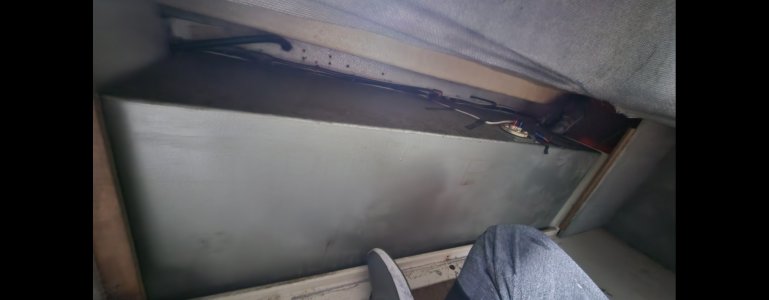

I dont think you can put it on the side.
I know it's not ideal, but I don't really have any other option. I can't get to the top. I looked on Tec tanks and it says it can be put on the side but it's not ideal.
Any other ideas I'm all ears, I'm not the best with this type of thing

Because this is my tank, there is only a couple of inches above the tank and the roof of the board. I can't even get the sender out. The only part of the tank I have access to is the side facing me
My old fuel tank was in a very similar position....to replace it the engine came out and the salon floor was cut open...even then the replacement tank was shorter so it could be replaced with all the fittings. The other alternative was a big hole in the side of the boat...but this requires a detailed knowledge of what it might do to the structure of your boat...and a leap of faith
What is above the tank ?....is it the side deck..?....a hatch could be made in the fiberglass....with the added bonus of giving you permanent access
