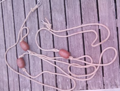

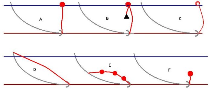

After having tried all of them, if necessary I now use type "E".
It does not tangle either boat/keel/chain even after repeated 180° turns, it does not annoy other boats passing by, no need to swim to use it.
The floaters must be made of stiff foam, those for underwater nets; the swimming pool ones come up crushed.
Here it is, on the anchor side a fixed shackle is better, sometimes the opening ones have gone free, possibly because of the amount of soil accumulating around them. The other one is attached to a specific point of the chain where I put some markers.
What's the difference between 'A' and 'C'?
"A" is the fixed length rope one, "C" should represent that sort of automatic buoys which adjust the length following the height of tide: some are massive (like the Swi-Tec one) and can be used to retrieve the anchor, other have rather flimsy ropes and are more used to signal the position of the anchor to others than to recover it (ex. "Anchor Roll").

The best solution is to only use a trip line if it is absolutely necessary and then take the additional precaution of having a weak link (a cable tie works well) a couple of metres below the float. If the float catches on a boat the weak link will break, freeing the float. If you do need to pull the anchor out backwards there should be enough slack to hook onto the trip line before the weak link.
There are other solutions such as some of those outlined in post #7. "D" and "E" are worth considering, but these are less effective if the anchor is caught or especially if the chain is trapped.
