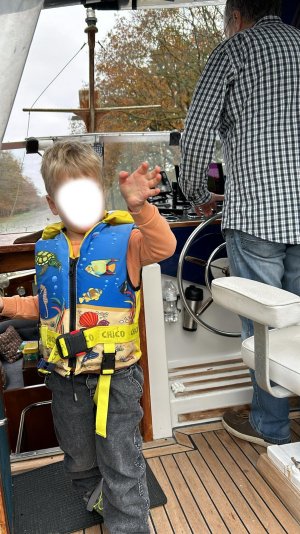

We bought 2 life jackets for our grand kids when they come out on the boat with us, our youngest daughter had bought 2 "life jackets" for her sons to be safe when out with us, but trying them out in the pool they were buoyancy aids and let the boys float face down in the water without turning them over on to their backs to keep their heads out the water, we showed the difference to our daughter. Weight is not the only factor to take into account our youngest granddaughter is tall and skinny and at 10 years old does not fit in the kids lifejacket any longer even though she is within the weight range of the lifejacket, she has grown too tall for it.
Grandson, 4yo.
Last Thursday we bought a few new lifejackets in bigger sizes for the grand kids and kids
