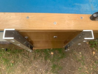

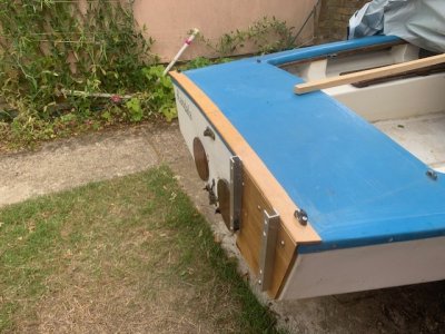

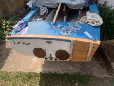

Outboard Mount Now 95 % Complete. Just got to make the slide in Board which will probably be made of 2 Pieces of the 'Plastic' Chopping board sandwiched together. And yes it is all bolted and screwed through to strong points made of the Chopping board stuck with CT 1 to the inside of the Transom. That chopping board is about £2.99 from QD and is good for many things. Very strong, Drills well and takes a screw incredible well. I await all those comments that say it will fail and the world will end cos I used it lol :ROFLMAO: (y)
OB Mount 1.jpgOB Mount 2.jpgOB Mount 3.jpgOB Mount 4.jpgOB Mount 5.jpgOB Mount 6.jpg
The 'Chopping board' will have a curved piece of timber like the piece on the top of the rear deck fixed to it so some of the weight from the outboard (only 12kg in total) will rest vertically on to the curved piece fixed to the deck. These curved pieces were slats out of a skip from a chair. They were curved to the exact curve of that back deck......... Great success

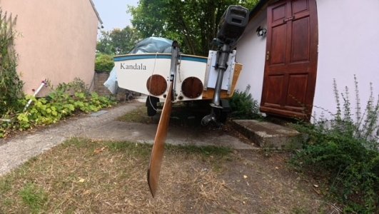

I have been a little busy but have finally got the little 2 hp Suzuki mounted on the GP 14. My motor is a short or standard shaft. In the pic below this is as low as I can get it. It would be nice if it were a couple of inches deeper but hopefully it will work.
See pic below...... What do you think
Depth looks good - Cavitation plate below hull - good length shaft - Looking forward to seeing a video of the sea trials -
I dimly remember boats being powered by an outboard, probably a Seagull, on a detachable bracket attached to the quarter. Might have been XODs from Itchenor.
I'm trying to think of advantages, at least it would make the motor easily accessible and there would be no prop chewing the rudder.
I am no sailor but have done a lot of power boating. My plan is to launch the boat from the slip. Row out say 30 m then start the outboard. Motor up the river with me and her indoors on board. Get to a safe bit in a low wind, pull out the front sail as I am fitting a furling thingy and have a sail having switched off the motor and pulled it up. Have a play around and possibly put up the main sail. Once done motor back. Although her indoors comes with me in many sea conditions all over the UK in our various ribs etc If I tip her out it won’t be good karma. Also I ain’t gonna sit there becalmed on the wrong direction tide wondering how to get back……… I recon that is a lot of advantages
