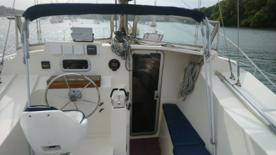

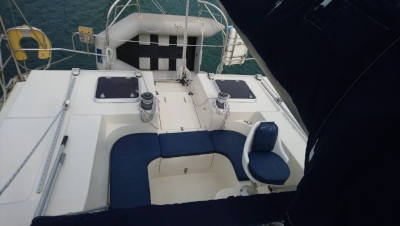

Thanks for that - here are a couple of pics.

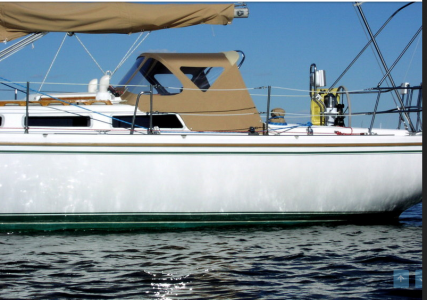

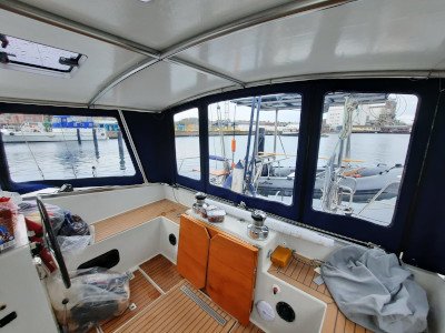

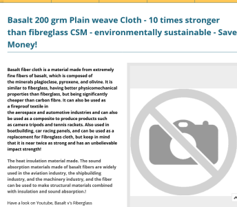

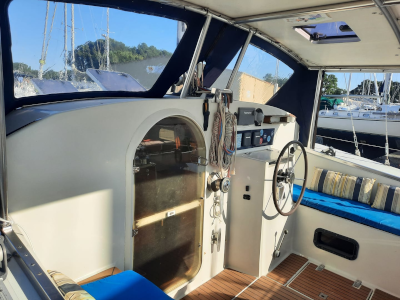

Looks lovely - esp. like the colour. But is that a hard top or canvas ?

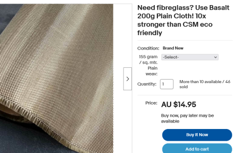

Well If I did it there would be a SS frame but I'd use fiber-glassed Basalt 200 grm plain weave cloth so it would technically be a "hard dodger"? I'd put a khaki tint in the f/g resin.
I'd glass it on a "bendy plywood" mold (very simple)
Austral Bendy Plywood
You've made my day! I think it looks lovely too and I think that's what I will build.:D. I
Screenshot 2023-10-03 at 18-40-50 Need fibreglass Use Basalt 200g Plain Cloth! 10x stronger th...png
Screenshot 2023-10-03 at 18-41-56 Need fibreglass Use Basalt 200g Plain Cloth! 10x stronger th...png
