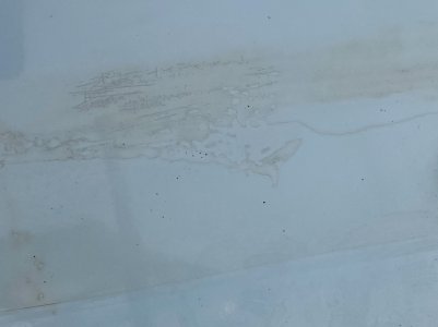

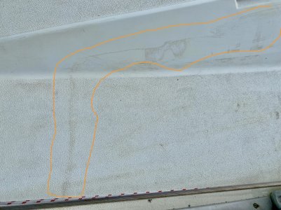

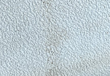

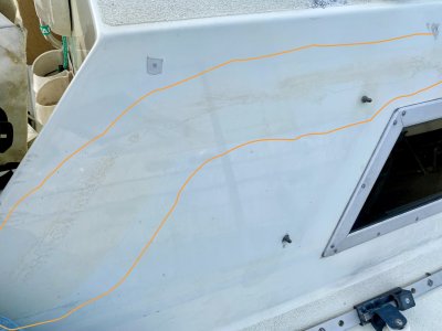

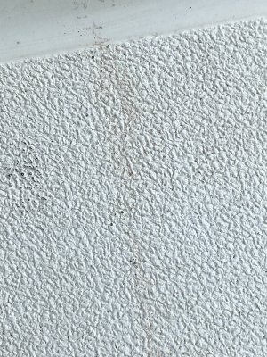

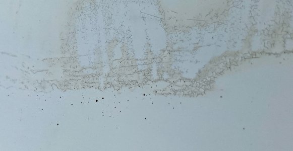

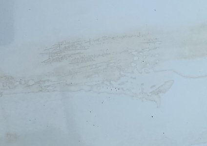

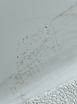

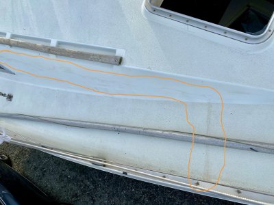

I have some gelcoat damage on my cabin tops. I can't work out what might have caused it.
It follows a similar pattern on both sides of the cabin top, with the damage following a rough line along the gelcoat where the vinyl decals used to be attached. It also appears to end with a stained line running across the non-slip deck as if a liquid has run across it. The pattern seems too structured to be just random degradation with age?
Does anyone have any ideas as to what might have caused this sort of damage / staining? And if so, whether there's anything I can do to reduce the staining?

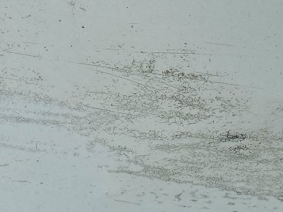

Up close, it's a mixture of small 'crazing' in the gelcoat, orange/brown staining, and what seem to be pitting in the gelcoat.

Looking at the photos I can make these comments.
Photos 1 & 2 looks like a run off of acetone used to dissolve the remnants of adhesive.
Photo 3 looks like a reaction between the gel coat and the adhesive or the gel coat has been affected by the acetone and then UV light has discoloured the gel coat.
Photo 4 crazing is something I have seen on boats that are about 40 years old. What causes it, \i have never discovered.
Photo 5 - 9 the small bubbles in the gel coat were due to poor brushing out of the gel coat mix in the mould leaving these bubbles close to the surface of the gel coat.
It would be useful to know what boat we are talking about and when it was moulded. Also you might find my presentation on gel coat renovation worth looking at. https://wiki.westerly-owners.co.uk/images/8/86/Gel_coat_renovation_19May2020.pdf

Thanks @Concerto
1986 Moody 28
It makes sense that the run off could be related to using acetone on adhesive, and might explain the pattern of staining roughly around the previous vinyl
Re the bubbles I presume they will have been revealed over the years by polishing in that case? and I guess that they are more obvious around the staining where people have attempted to abrade away the staining in the gelcoat therefore

The crazing is almost certainly u/v damage
Occurs a lot on boats from a few builders, Westerly gel coat particularly so. Not structural but not easy to permanently disguise as painting does not always work as the crazing is inclined to print through unless you cut the gel coat back below the depth of the crazing.
The pitting is almost certainly as has been already noted, air pockets that have been exposed just under the gel coat. Aeration of the gel coat while she was being built. The liquid gel coat was possibly not left to stand for long enough after aggressive machine mixing. Not easy to fix as you cannot fill the little pockets as the air keeps pushing the filler out. Again, a necessity to sand the gel coat to open them more.
The staining.... Not sure but certainly related to the decal or decal removal method. Chemicals can cause gel coat staining, the best way of removing decals is with hot air from heat gun.... If you get the temp exactly right the come off easily including the glue... Too cold they tear and leave glue behind... too hot and they melt and tear. Plastic or wooden spatula won't hurt the gel coat.

A GRP guy I spoke two said it's because the gelcoat is thinner as what is now an inside radius was an outside radius in the mould and also because it gets more UV exposure due to the reflection off two surfaces.

Rather than trying to remove any fine UV crazing entirely and risk going through the gelcoat I use fine wet and dry (1500-2000 grit) with HG Mould Spray (which is basically bleach) as the lubricant. Most of the crazing and staining will dissappear (at least to the naked eye), although you do have to seal it with a good polish/wax having washed off the bleach or it will attract the dirt and reappear.
