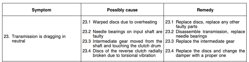

I have some files to share. Unfortunately two of them too big to be allowed here as attachments, but PM me your email and I'll send them over:
Repair Manual Parts list ZF 25 A_ZF 25_ ZF 45 A_ ZF 45-1 code 310.01.00 76 pages
Workshop manual and parts list ZF25 to ZF45-1 85 pages
Snip from manual
A general description is attached here
  • ZF45A.pdf
