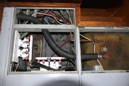

Correct, any Racor 500 element (or pattern) will fit. My engine does not have an on-engine secondary filter, so I have two Racor 500 clones, one with a 30 micron as a pre-filter, and the other with a 2 micron element. They are identical filter housings.
