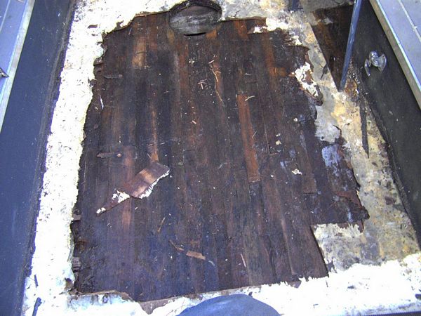

I established that the central cockpit floor crunched and moved underfoot, as did that by the helm. This is going to need ripping out and replacing - probably stringers too. I've already removed the glued down rubber floor and determined the crunching was the top ply laminate - now mostly removed. The floor appears to be of a hardwood, blockboard construction where strips of hardwoods are glued together (approx 15mm profiles) and sandwiched between two thin layers of plywood. The plywood and rubber floor have trapped moisture and thus the ply is rotten and brittle - pulled up with fingers. Surprisingly the block-board section, although saturated with water is not rotted! It will however need to come up as it has sagged and distorted - plus the layer of ply below is rotten. After 24 hours exposure to the air, it's already drying out.

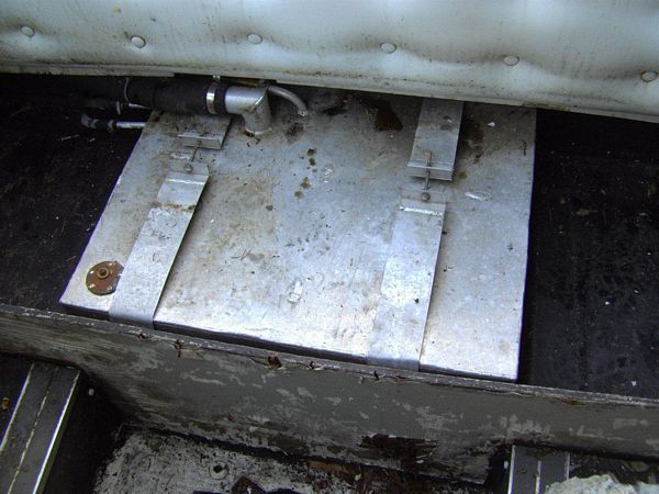

The floor of the battery bay seems solid and could be stood on, but the other side (starboard) contains a hole and is clearly rotten. The ply is very thin, so may replace both sides anyway. What can be pulled out with fingers has been in order to expedite drying of the foam beneath.

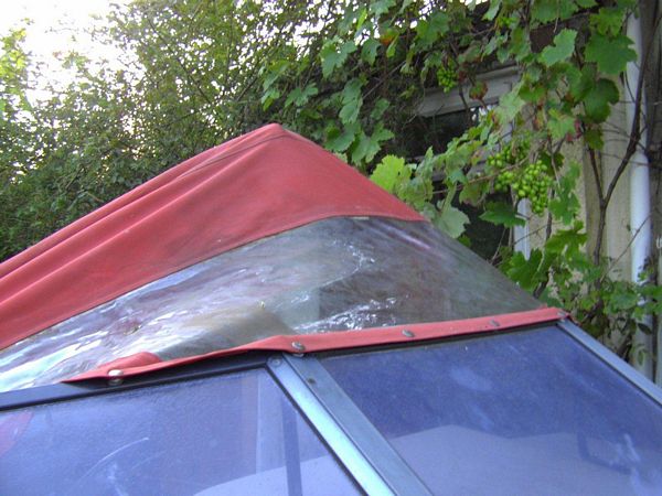

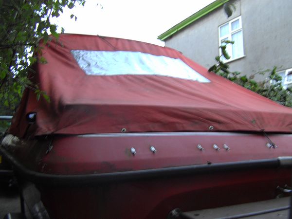

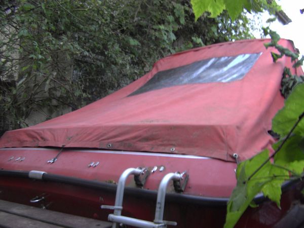

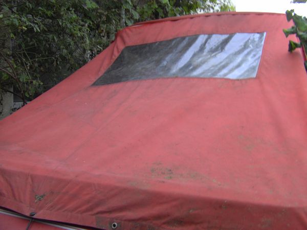

The camper cover had shrunk and the 4 sections of frame are clearly missing some bits and appear to need attaching somewhere - not obvious! In order to prevent water/leaf ingress and aid drying, I have fitted the cover (by soaking and stretching parts) and initially 'propped up' using the rear seat as a tent pole! I've now used part of the intended frame however and I'm starting to determine what elements are missing/lost. It is however a major bonus to have even a quite tired cover as it is complete and will suffice as a template for a new one if needed.

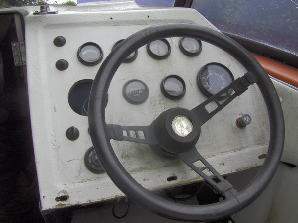

Gauges are all present except for tacho, but from attempts before leaving Scotland, we know that the hydraulic pump and 'up' relay don't work. The propeller is quite pitted with a few dings, so will get that off and sent for refurb as this isn't something I'll be able to do. The sterndrive was a replacement and a new gimbal bearing and gear selection cable have been fitted. The engine was claimed to be rebuilt when the previous owner purchased, but as he said, he saw no evidence of that, although it does look fairly 'clean'. The oil in the rocker casing and dipstick does show signs of partial emulsification, but too early to say if this indicates a problem. Having sat outside through the last couple of winters - and in the Highlands - it could just be from condensation/freezing etc. New oil, plugs, belts etc will be done before starting, so all will become apparent no doubt! If a partial rebuild is needed then it will be done, but will obviously delay the completion. I'm mechanically minded and have changed head gaskets on Land Rover V8's, so a rebuild would be partly DIY and partly machine shop or exchange, but we'll cross that bridge when we come to it!

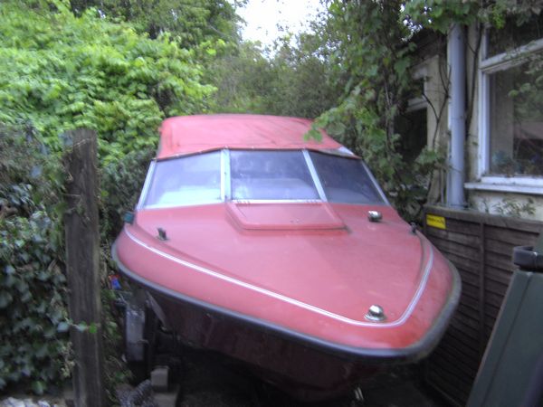

General exterior condition isn't as bad as I thought it might be but it has been resprayed at some stage a long while ago. The supports for the stainless rail around the sundeck have blistered beneath the black coating so I may need to get some made from stainless if they are not 'standard' bits. Some of the gel coat has flaked away and some crazed, but these sections are quite small and manageable.

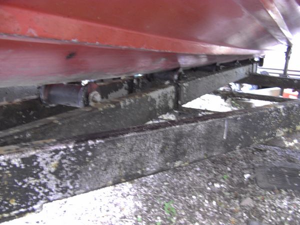

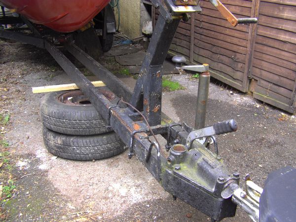

Trailer is marginal as to if it's repairable. Although quite rusted, it is mostly solid apart from the nearside central spine which has rotted away on the rear 24-30" (holes!) and the leaf springs are very rusted. It's a bunk with some rollers. Hubs are an unknown, but bits were rattling inside on the journey home! :shock: The wheel bearings seem good (no heat in 550 miles non-stop!) and only one has a little amount of play. Two were replaced recently and the other two greased I'm told. I purchased two new wheels and tyres to collect it, but the other two could do with replacing soon unless I replace the entire trailer with a new one!

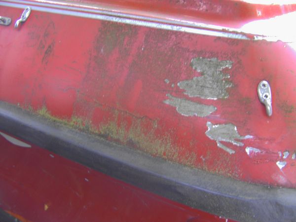

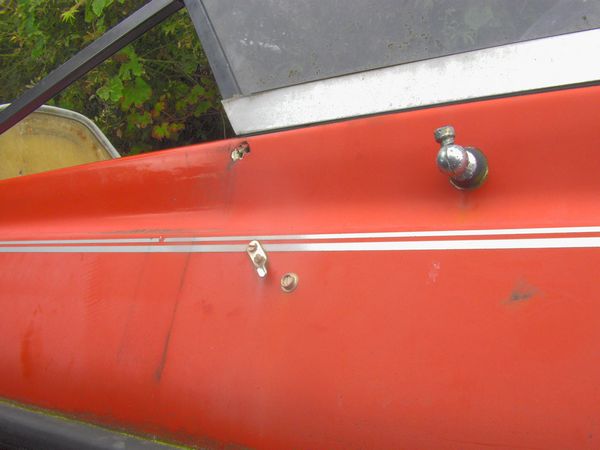

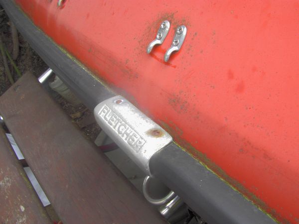

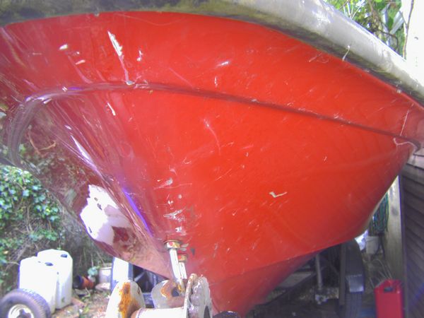

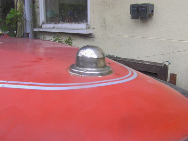

General hull state - a selection to show various bits - good and bad plus many original fitments etc.

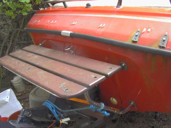

Swim platform - surprisingly more solid than it appears. Not sure if this was original or not, need to find more pictures of Arrowbolts of this era perhaps?
This is probably the worst area of gel-coat (or lack of...)

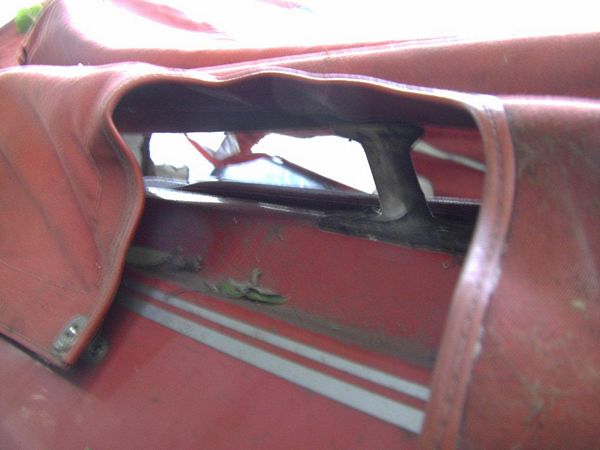

Shame cover hadn't been on the last few years, but it was at least preserved dry in the cuddy - needed some soaking/stretching to fit! Only a couple of minor tears found.

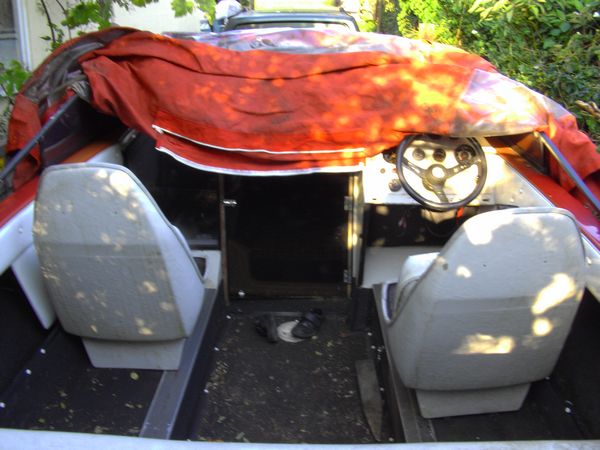

Some cockpit pictures...
It's not every boat has a lawn to mow...
Original floor before rubber mat and ply laminate removed - some give and crunchy!

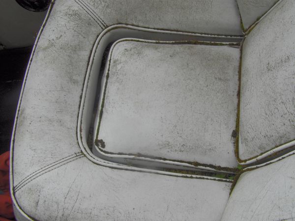

Rear seat back not fixed and tends to lean forwards - coverings in pretty good nick for age, but suspect bases etc will be rotten and thus new seats will be almost certain.

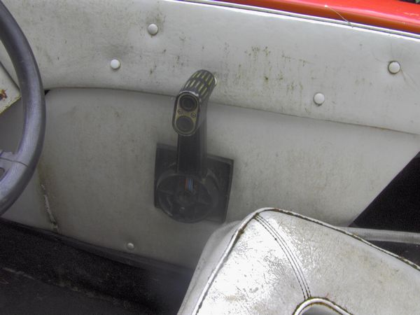

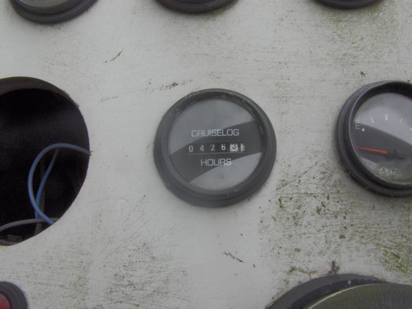

Console is mostly complete with just the tacho missing...
Nice, low mileage example guv, one careful lady owner...

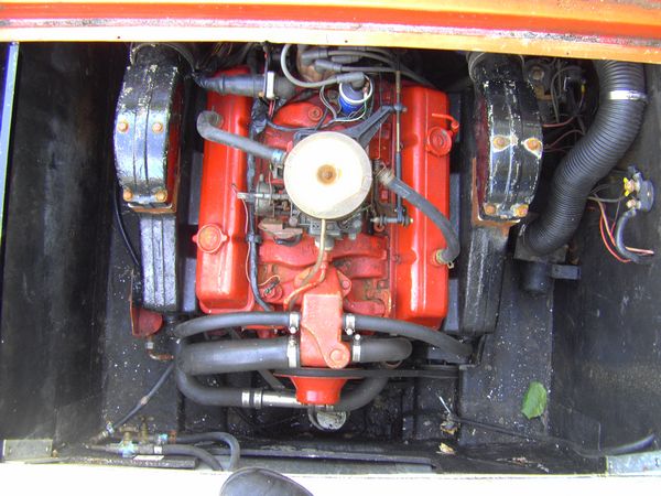

Under the hood...
No fire suppression, so that will be a must and in in budget anyway - ample space to install.
Surprised to find bilge blower given age, unsure of condition as yet.
Bilge pump isn't going to pump what's down there, perhaps a macerater?

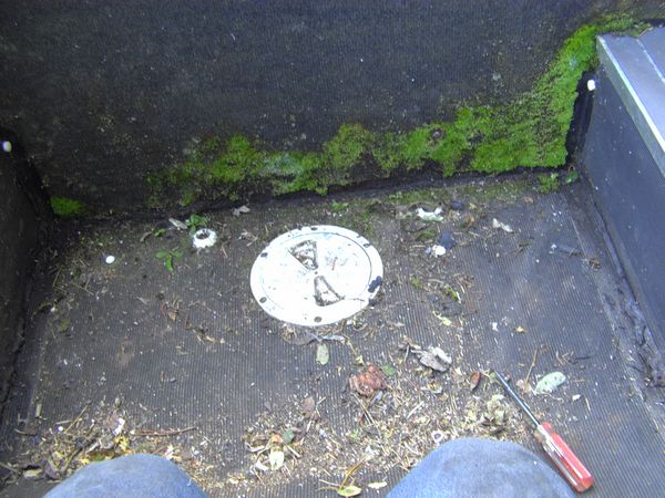

Battery bay seems solid and clear of rot - but nothing taken for granted. Will fit a couple of big leisure/starters in there and wire a split charge. (Apologies for fuzzy pic - must have had one too many coffees... )

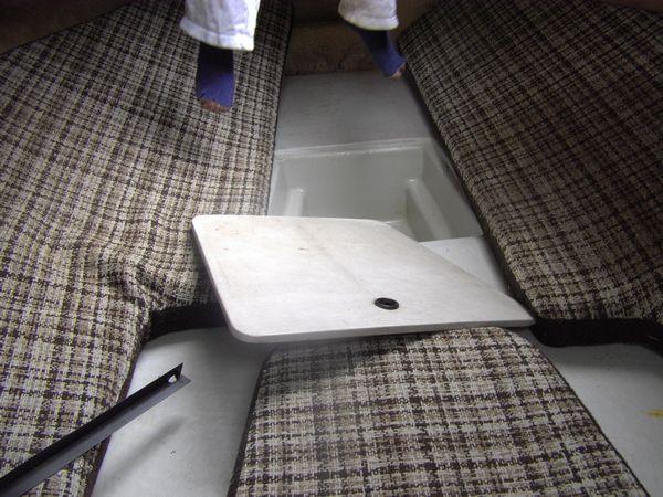

The cuddy area is clean and dry...
Headroom is 'limited' as illustrated by my son!
Floor is fibre-glass and doesn't appear to be wood beneath, but there must presumably be stringers supporting? I'm hoping not to have to cut this out, but that may be optimistic and if necessary it will be done!

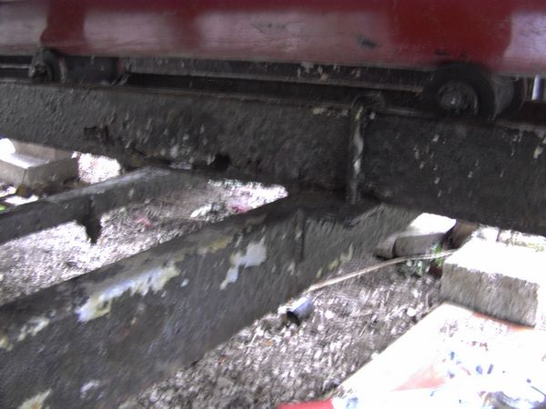

Hi Dave, I think mine might be too far gone to repair cost-effectively. Unfortunately, it's not galvansied and the spines are open and thus appear to have rotted from inside out. Caught a lot earlier, could have been wax-oiled inside but a bit late now. I may try and get new sections made and galvanised/dipped, but will depend on cost. I like the leaf-spring arrangement as it has an articulation in the centre that compensates for tow-height and distributes the load well between the axles, but not sure if new leafs will be available? I'll clean it up and then seek some prices from local trailer centres for repairs/parts. Regarding the welding, I have done some self-taught metal arc welding a long while ago, but although I brought a mig some years back, it's never been used :o I'm hoping to do an evening course on welding and then I might assess if I'm competent enough for DIY job! :rolleyes:

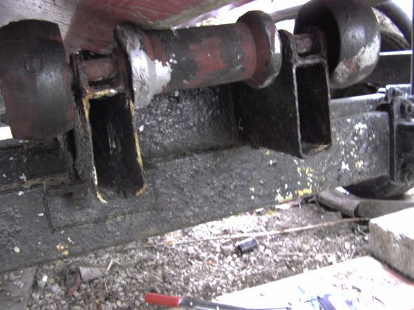

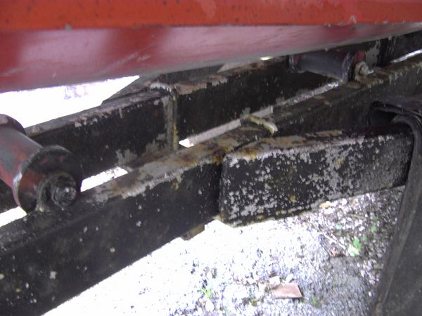

Trailer Pictures - apologies for quality, light isn't that good as enclosed on all sides.
The sections joining in at about 30 degrees are not welded to the spine, but to a plate beneath which the U bolts clamp to the spines...
These next three show the worst of the corrosion - yes, the dark bits ARE holes!!! (I poked fingers through :eek:)
I'll look to build a timber cradle for the boat out of 4x2 and then pull the trailer out from underneath. It's currently jacked up on axle stands and blocks so that the springs and wheels are unloaded. I'll probably start with the trailer anyway as that's a significant expense if replacing and will determine a few other decisions. It will also rot further in the elements if unattended, whereas the boat won't (now covered and drying out quickly.)
I'll probably build a timber frame around the boat and fix a tarp over so that I can both keep it dry and work through the winter as conditions and time permit...

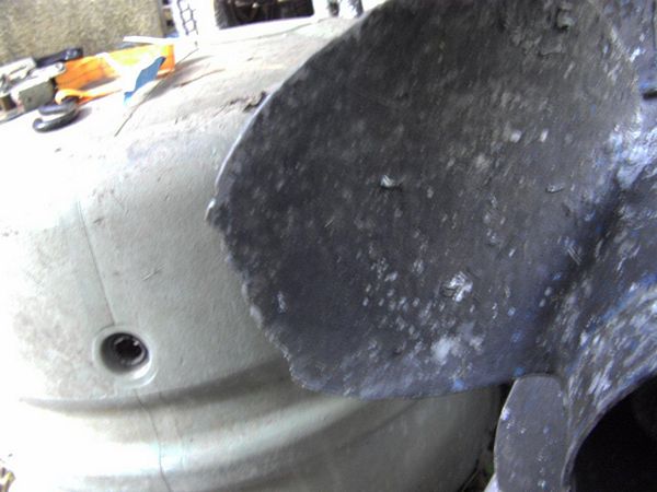

A 1/2" mooring line broke and the chap next door had a stainless steel prop on his trimmed up out board (NO! it was not running at the time.) :)

Crikey! I thought the sharks had acquired a taste for GRP... :eek: I hope he's footing the the bill, you must be gutted? :(

I fitted the canvas 'camper cover' but with no fixings for the frame and an obvious absence of one or two bits, had to botch with some cable ties etc for time being. Ultimately a new cover is very likely to be needed, but at least the old one now fits (having been well watered by the elements) and can be used as a template. Although she started to dry out, it's clear that canvas is no longer water-proof and a few large puddles reformed inside so a tarpaulin has now been put over entire boat with airflow maintained as much a practical to prevent mildew etc.
I'm aiming to aid drying by running up the motor and winterising at the same time. :rolleyes: I've still not be able to identify the V8 Penta for certain, but as of last week sourced a syphon, oil, filter and fogging oil. I hung upside-down again at the weekend and removed the four port-side plugs ready for some derv/wd40 and then a hand crank to ensure free turn over. Unfortunately couldn't turn a ring spanner on starboard plugs (no room) so had to abandon pending a 16mm plug spanner which I now have. Hopefully will find time this week to remove remaining plugs and then ensure free rotation. Next I'll check compressions and then, all being well, fire her up and run to check temperatures, water circulation etc and change the oil.
