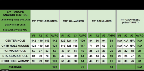

This is a bit of a long video but I think it answers everything said/questioned in this thread.
If you don't want to watch it all, the obvious solution is, as JFM said, stainless steel chain is the solution.
And this is the summary chart referred to in that video
I think that is pretty much QED (as we used to say in school).
Amazing what you can find on youtube!
That's pretty convincing proof that traffic cones (and probably "boys") don't help at all, and that stainless steel chain meaningfully improves things and basically solves the problem.
The youtube doesn't look at the question of which chain is best at not getting jammed when the anchor is deployed, but I can assure you that stainless steel chain is much better on that score too. I've done a decade+ of boating with galv chain, and a decade+ with stainless, and am 100% convinced that stainless is far better in this regard.
Totally agree. I have had both and wouldn’t go back to galvanized. On the way out have never had a problem with s/s and we often drop 70m plus. That said on the way back in s/s doesn’t solve the problem entirely, at least for me. As chart suggests at some point it does pile up on my boat and needs to be swept aside.

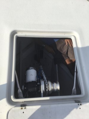

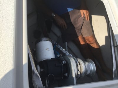

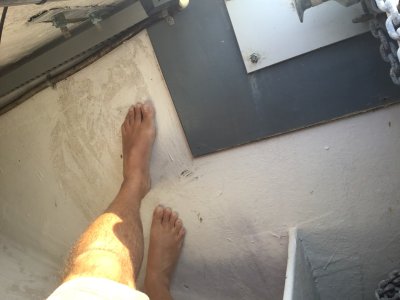

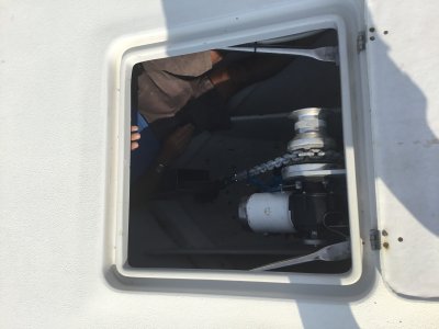

This threads all alien / foreign language to me . Live n learn every days a school day on here etc etc .
If you have a deep enough locker and cavernous enough you never see this hassle .
laying out at full stretch , Stood up at under 6 ft my head just pops over the deck .Never had any issues with 70 M of 10 mm galvanised .You never normally see the chain anyhow so any blitz / glamour will be wasted .
