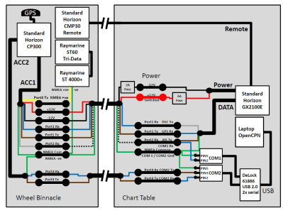

I did the same as you with a Bav 36 ... it just had speed, depth, autopilot, and a knackered plotter with an out of date radio - and at the time Navionics wasn't an option.
I bought a budget plotter and VHF/DSC radio with an inbuilt AIS receiver and built it up from there ...
Went from this ...
To this over a period of 10 years ...
The tablet in the second picture had both GPS and AIS info working on Navionics but was unable to send data to the autopilot like the SH CP300
The options today depend entirely on the depth of your pockets - but my advice is don't splash too much cash until you've sailed the boat for a while - no point in spending a small fortune on electronics to discover you need a new windlass, and engine overhaul, or new sails.
