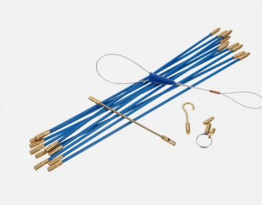

I use a set of these - loads of people selling them on Ebay/Amazon
Mine are about 1m long but I also have an interchangeable set about 300mm long.
