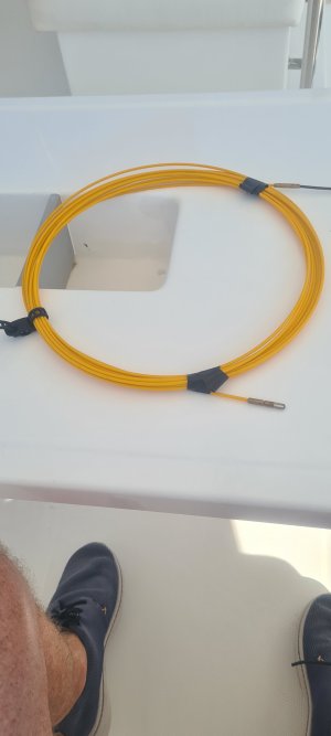

My son and I did some very awkward cabling on my relatively new to me boat a few months ago. He bought one of these things [which may be called a cable snake] and it made the job easy. View attachment 182218
Was about to suggest this, its actually called a "fish tape". You also get a plumbers version of it where you can reorientate the head to go a particular direction but they tend to be ony 2-3 metres long
