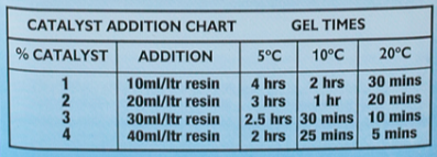

With polyester the proportion of resin to catalyst can be varied to vary the gelling time and to suit the temperature eg
