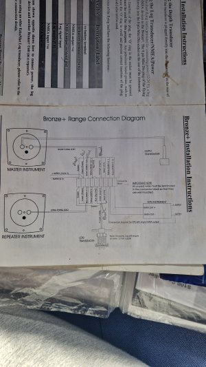

I Have an Echopilot Bronze Plus paddlewheel log. It appears to have 4 wires in a grey sleeve.
I want to connect it to an nmea converter, but I can't find any info on what each coloured wire is. I presume a pos, neg, and a circuit carrying pulses from the paddlewheel magnets.
Can anyone show me a wiring diagram or manual
Its from a Echopilot Bronze Plus trio. Probably not available anymore...

3 pages from my manual , let me know if you need anything else out of it
