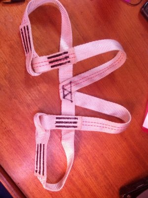

Hello GHA, back to your specific case, I made myself a "not-MOB harness, I am usually singlehanding so no need to lift anyone out of the water, should I ever sail near someone else floating with a lifejacket and asking for help I'll try to do something :)
Personal take, I find the more complicated it is to wear one the least likely I'd always wear it, a thing like this (first picture taken from the net, no idea if good or bad) I would probably wear it once to take some nice photos hey-ho then it would likely be forgotten inside a locker.
The simpler I could make are from only webbing, with a soft shackle to close the two front loops and serve as attachment for the tether.
I make them to measure, no steel adjustment buckles to rub against my ribs. They are light, unobtrusive, may also be kept permanently over the garments; during those days when one is putting/taking off oilies all the time I can use two: one nearer to the body, one over the oilies. No problems in wearing or sleeping in them for days.
The attachment point is very high, slightly above the sternum bone height: I have been tossed on the boat a couple of times with a regular lifejacket harness and it almost broke my back, with this one it's a lot better.
I don't know if one could be retrieved from the water with such a harness but I do not care it's not its purpose anyway, it's a not-mob harness. :D
Regards, r.

I have a similar one. I added fleece; more comfortable in the summer here. I also used 2-inch webbing for the chest belt-only for better impact distribution. Yes, it rides high, like it should (PFD harnesses are way too low for proper harness function). No metal until the tether is added.
Something I will actually wear. Actually, one of the main functions is fishing. I'll be out on the tramps, working on trolling rigging with both hands or hauling in a big fish, not paying attention to the waves. Anything where I don't have a spare hand and my attention is elsewhere.

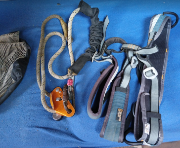

I've used this for years solo, grillion is great, very much instinctive to always take up the slack without thinking about it. Sometimes gets worn day & night for days on end. Great at the mast, lean back with both hands free. Really should get into the habit of wearing it much more often even when it's calm. Marseilles soap is a new favourite thing & keeps the webbing supple & smells nice too. Caribiners must be heading to 20 years onboard, little wash & dab of oil keeps them easy to use. Handholds on deck I know in my sleep though rarely go past the mast in any kind of weather. Remember not leaving the cockpit for 5 days straight on one passage, ah the trades..😁
Though interesting thread, bottom line I reckon is we just don't know what works best, just no bags of data to go on & our brains love to make up stories about how in control & clever we are rather than face up to the concept of being quite wrong 🤣
Though pretty certain staying onboard is one thing we should be practicing & thinking about constantly, little & often, much, much, much, more than any of us do! 🙂
