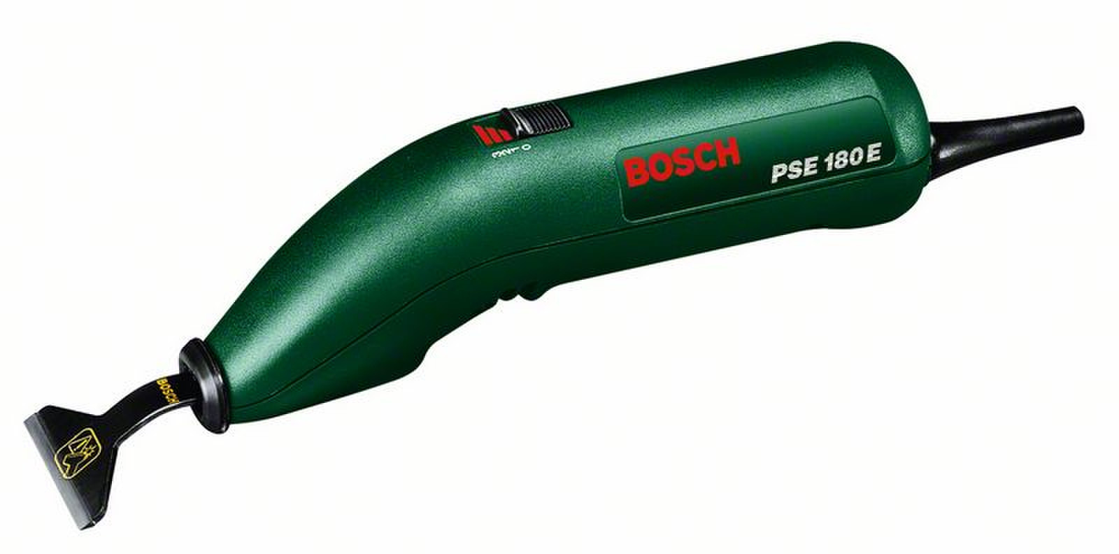

Well, I bought one of these second hand off Ebay
Will report back when I have used it.
- W
Good call I reckon.
Get lots of blades.
Get good PPE.
Good luck!!

Good call I reckon.
Get lots of blades.
Get good PPE.
Good luck!!

Remember to grind the corners off the blade or you're likely to get some deep scratches into the gel. I used one of those 9 years ago but found it quicker with less damage last winter to use a 2 handed Bahco type scraper.
Yep, going to grind the corners off. Will also get a Bahco as a backup.
