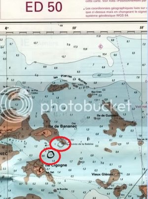

If you can find an oldish chart of the relevant region of Portugal using the ED50 datum there may be a note with the adjustment from ED50 to WGS84.
On my south Brittany charts the adjustment from ED50 to WGS84 datum is -.06minutes N and +.09minutes W. Depending where you are in Portugal, you are about 40°N. I don't know if the same adjustment ED50 to WGS84 would apply in Portugal as in Brittany but I guess it would be somewhat similar.
At 40° N, 1 minute E or W is 0.766nm (about 1550yards) and 1 minute of latitude is always 1nm (about 2026yards). So the difference of -0.06minutes N would be about 120 yards in a southerly direction and the difference +0.09minutes W would be about 140yards in a westerly direction.
