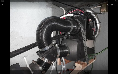

Agree, those flex couplings can have a mind of their own . Mind you looking at my now 24 months temporarily install ( to be made permanent once ime happy with it all) . You can clearly see why i do check on a regular basis lol
