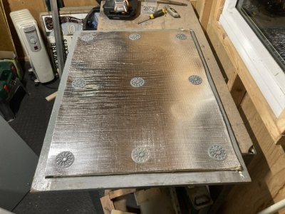

I replaced the egg box foam on the underside of the saloon floor panels above the engine bay during the winter. Having explored various options I went or Aquafon , which was recommended by ASAP supplies. I used the 27mm on the basis that the 30mm added weight for only a small increase in sound reduction.
The fixings that are supplied with it are pretty poor but I used insulation fixing discs and screws, which worked well. Overall it seems to do a good job.

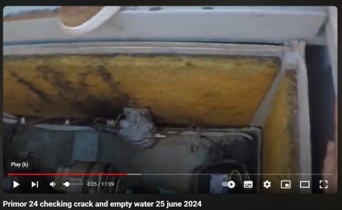

My mobo with a 6cyl 170HP lump in has soft sponge like foam bonded to the panels / bulkheads ...
Sound needs that soft style to absorb the sound waves .. stiff egg-box style will not deaden it .. on;y partially ...
Still from the repair video showing the soft insulation ..

did it make much difference to noise? I could try and put this over the current egg box foam stuff I guess without much penalty.
Difficult to assess accurately as there was six months or more between using the boat with the old and then with the new sound insulation but I would say that the new stuff is better.
Not sure if installing over the egg box stuff would add value but if there is room I guess there is nothing lost in trying and in that case the provided fixings might work on vertical surfaces but you would need to get them behind the foam, probably by cutting a + and sliding one in (they are a square plate with a metal rod attached - the plate sticks to the bulkhead and the rod pierces the insulation and a fixing goes on the rod to hold it in place. NB the rods are too long and would need trimming).
