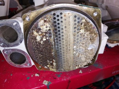

I finally bit the bullet and in order to clean the port heat exchanger, we cut a panel from the saloon floor over the engine and in between the steel support framework. It was a simple enough job compared to the mammoth task of lifting the whole floor which is the designed above engine access for a Pearl 50. There is easy access to the inboard heat exchanger and CAC. The opening measures about 60 by 70cm. My engineer is not a small man but was able to get in and do the job. It also gives better access to the raw water pump. Next is the starboard side and the outboard CAC, which will be a little more complicated as the seat has to come out.
Attached is photo of the heat exchanger. I rather doubt Rydlyme would have fixed that!D9 heat exchanger 10 years 800 hours 20240103_181840.jpg

Jeeeeez, it must have lost 70% of it's cooling capacity 😳

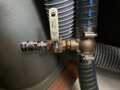

I’ve fitted a fresh water flush valve after the sea water strainer to ensure the heat exchangers are not sat in salt water for long periods..I’m hoping this will give me a bit more time before a major descaling is required.. this is on a Cummins QSB though.. not a volvo D9…68DAA197-B011-4D8D-A1C8-DFF82BF663F8.jpeg
