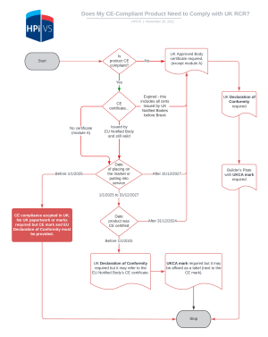

From that article:
A product must comply with the legislation at the point it is first sold or put into service in the territory.
The UK Government is not recognising the EU Recreational Craft Directive (RCD) as an alternative act to the UK Recreational Craft Regulations.
It is recognising European compliance as a means demonstrating compliance with the UK RCR. This subtle point is of importance later.
If the boat is CE-marked, one might think that this announcement means that the boat is considered compliant in the UK but remember point 1 above.
If the boat is coming to the UK today, it must comply with the regulations today.
There have been three versions of the Recreational Craft Directive (and Regulations) and if the Declaration of Conformity that accompanies the boat declares the boat complies with the current RCD (2013/53/EU), I cannot see why the UK enforcement authorities (Trading Standards) would take issue with the ‘freshness’ of compliance.
Note that this version of the RCD became mandatory on 18 January 2017, so if the boat is younger than this, it could only have complied with the current Directive.
The article does state that there's only one company in the UK that can test older boats (the authors) and that he doesn't think it will be well policed, but the article clearly states that compliance with RCD(2013/53/EU) is what is needed to meet RCR, not the previous versions.

If the boat in the EU doesn't meet the latest EU RCD, then no, it will need a UK RCR Post construction assessment
The boat in the UK isn't being imported or sold as new, so there's no legal event to trigger the requirement.
This is one of the consequences of the UK's wish to diverge standards. It's only fairly recently they allowed the latest EU RCD to be used as evidence of compliance with RCR. The initial rules meant that every single second hand boat imported to the UK would require a PCA test (despite the UK only having one small test facility).

From that article:
Thanks. The important wording seems to be:
"A product must comply with the legislation at the point it is first sold or put into service in the territory"
Does 'territory' in this context mean the EU territory in which the product was first sold or put into service?
Or, does the whole compliance process refresh if it is then sold in another territory?
The former interpretation would seem to be more likely because manufacturers can't be expected to certify items that have been outside their control for a period of time.
HMRC guidance includes the following (my emphasis):
"8. Obligations of private importers​
A private importer is any natural or legal person (e.g. a company) established in the UK who imports in the course of a non-commercial activity a product from a country outside the UK with the intention of putting it into service for their own use.
The obligations of private importers include:
  • If a private importer imports a product that has not previously been placed on the GB market, where the manufacturer has not carried out the relevant conformity assessment procedure, the private importer will have to carry out a post construction assessment to demonstrate conformity with the Regulations,..."
And looking at the website of the organisation from which the author of the PBO article hails, there is the following flowchart:

Doesn't matter if it's an exact replica of one in the UK. The move from the EU standards territory to the UK standards territory requires proof it matches the current UK standard. The fact it was built in the UK to a previous EU RCD standard is completely irrelevant. That is UK law (it didn't need to be, but the current government decided it would implement it this way as a non-tariff barrier).
They did a huge U-turn to allow an EU RCD v3 certificate as proof of RCR, but that doesn't allow previous RCD versions to be used.
The EU is one standards territory, the UK is another.
Your emphasis matches what was said in the article. The relevant confrmity assessment is against the new version of the RCD. Previous assessments are not relevant.

It would, if it's possible. The PBO article seems to state that you can only get the assessment done in the territory in which you live.

That is a moot point in cases like the boat you are looking at because it would not meet the latest standards particularly with regard to the engines and quite possibly on basic design criteria such as stability where the requirements have changed around the boundaries between categories.

Thanks. Do you know where it is set out in the legislation (or perhaps in court cases since) that the relevant conformity assessment is against the current RCD?
I genuinely don’t know and am not trying to argue one way or another. But, if that’s right it’s pretty monstrous and means that for most purposes UK buyers shouldn’t waste time looking at importing any 20 y/o boat.
st599
9 Jan 2006
7,651
The relevant conformity assessment for the UK is the UKCA RCR (which happens to be the same as the EU RCD version 3 but with new covers). Recreational Craft Regulations 2017: Great Britain
Because it is the same (at the moment, it may not be in future), the UK Government after pressure from British Marine, RYA, CA and others reluctantly accepted current CE marking (against RCD 3) as compliance with UKCA RCR.
benjenbav
12 Aug 2004
15,531
Thank you. I’m sorry to have put you to the trouble of proving something that you clearly know very well but it does seem a really important point.
