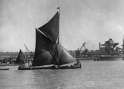

The same question could be asked about the sprit rig.
I think I have read all the published books about spritsail barges (I probably own a copy of them!) but I don't remember reading that they sailed better on the starboard tack, although logic says they would (the sprit usually being on the starboard side of the mainsail).
