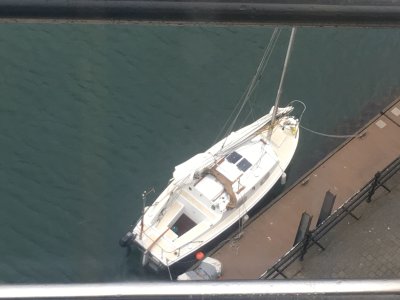

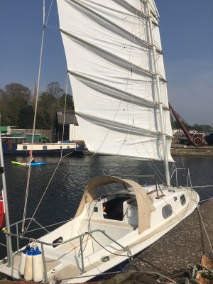

That is all true. But at a price. The junk is much cheaper to run as all the components are cheap, they don’t wear out quickly and when they do, they can be mended easily and cheaply.
I refurbished and sailed a Kingfisher 20 that I bought in a tatty state, having been converted from Bermudan rig many years previously. I’d be happy to do the same again - she was a delight to sail. But I'd not take on the conversion myself because of the structural work mentioned by Tranona and others.
I sold her because the cabin height became a problem for me - but a younger person would be fine.
(Btw to the OP - I have a copy of the Hasler / McLeod book PJR if you’d like it - at a modest cost. PM me if you are interested, also can send you pictures of the boat.)

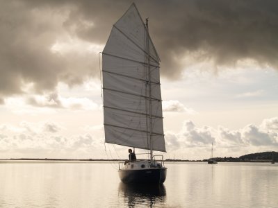

Here's an interesting article:
Bermudan rig vs Junk rig - Practical Boat Owner
Two Sprinters were sailed side by side, one with conventional Bermudan rig and one with a modern junk rig. The Bermudan boat was faster to windward but the junk was faster downwind, unless the Bermudan boat got a spinnaker up. And the Bermudan was a well-tuned, successful racing boat, whereas the junk was a work-in-progress home conversion with a slightly experimental rig, so clearly with some work the performance gap would be reduced.
The test was also done in light winds. In strong winds, the junk rig's ability to reduce and increase sail quickly and easily would be a huge benefit with a small crew.
My observation is that if you want to sail as fast as possible around a triangular course, or if you want to cruise as fast as possible with an active crew, Bermudan is clearly better. If you want to sail as many miles per year as possible, shorthanded and a long way offshore, junk would make your life a great deal easier and more comfortable. Horses for courses.
