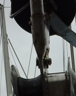

Below is a picture of my forestay attachment. As can be seen, the chain runs close to the head of the clevis pin. That's why the split pin is on the other side, where it can't get knocked by the chain.
A threaded bolt is never going to be as strong as a clevis pin. I had a clevis pin drop out because the keyring type retainer came out. A properly sized pin with a strong fixing would be my choice.
Please explain. Threaded pins are common practice in the lifting industry. I understand that the cotter pin is not load bearing, but I don't understand why a threaded fixture makes it weaker. I would honestly love to know. So would others.
I should add that threads don't always make things more secure; they certainly can twist off and must be additionally secured in critical applications. In some ways, a cotter is more secure and well proven.
But I don't think I would argue that threads make it weaker (assuming the threads are outside the shackle or fork).
