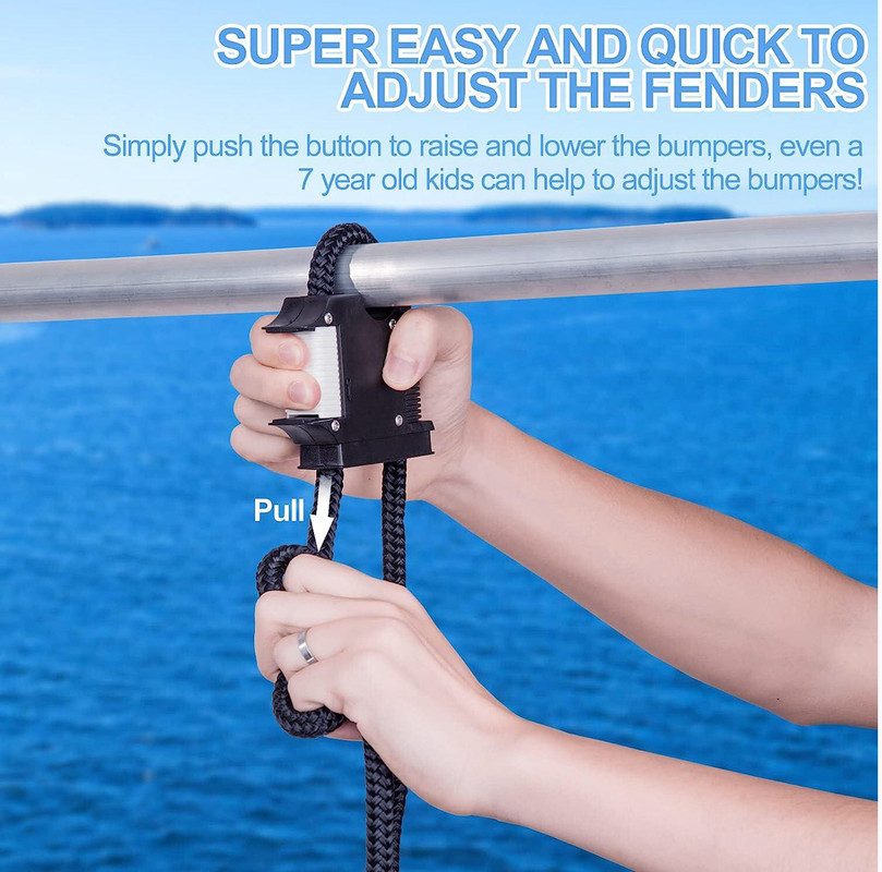

I use these...
So when I am coming to my pontoon berth, I let the fenders down to the waterline.....and when I’m going to berth Med style stern to, I can quickly pull up the fenders.
And at anchor, I pull them all the way up, so that they don’t band on the hull while sleeping nor obstruct the deck

Ooo, where did you get them?

I made something similar by cutting a short length of plastic pipe and cutting a slot in the side so the fender line passes through the pipe up over the handrail then under the line that passes through the pipe and passing the free end under the line where the slot is.
Easy and cheap using a short piece of plastic conduit
I think I got it from PBO some time ago
