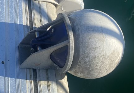

Whilst in France last year, I spotted these seemingly well-designed brackets for securing a fender to the aluminium pontoon edge. My efforts with Google and reverse image searches have failed to identify these. Anybody knows who makes them or where they can be bought?

I don’t know about this bracket but at a boat show many years ago I bought some two part brackets that formed a similar function. A chunky receiver is bolted to the side (vertical part) of the pontoon. Into this a large mushroom-like bolt passes through a fender eye and into the receiver. This gives a permanently mounted horizontal fender.

Interesting design but could cause a trip point on any jetty and it could cause anyone walking along the jetty to trip and fall in

Yes but this is much bigger and intrudes into the jetty walking space more the average horn cleat and there ae normally only cleats at each end and in the middle of the finger
IMHO a better design would incorporate a fender bracket into the edge of the finger not on the walking surface.
Ifs all about innovative design taking all factors into consideration that proper engineering designers do making the product better and more fit for purpose

I assume that one has asked the marina owner for permission to install such things. I do know of one marina where the owner went round & removed a lot of fender adaptions that simply looked messy. When I queried it at Bradwell 15 years ago, they said that due to the older design of the pontoon spacing, they frowned on such things, as it reduced the spacing. I can see the point when a visitor arrives in the berth & I do find it awkward when my fenders catch on the regular berth holders awkwardly spaced adaptions.
Obviously it is their berth so I should not complain. But I do make the observation all the same.
If one knows they are there then one might leave one's own fenders off. But in most cases there is not time to make adjustments when arriving. More so when single handed.
