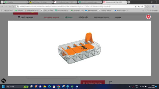

I admit I do use chocblocks but I also use Wago's ... the only thing I have about Wago's - is I wish they could have the tabs 180 deg to each other - so the cable is a straight line instead of both entering same side.
Inline wago connectors do just that. Wago 221-2411 32A 2-Way Inline Lever Connectors 60 Pack - Screwfix

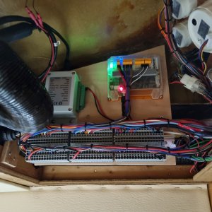

Wago make lots of different connectors, some of these are neat for multiple inline connections : 261-112/341-000 | WAGO 261 Series Grey Terminal Strip, 2.5mm², Single-Level, Clamp Termination | RS
I recently completely rewired my dash, twin engines and several gauges, so needed something fairly compact. I decided on these : 4-conductor through terminal block (281-652) | WAGO
With the fine, multi strand wiring we use on boats it's essential to crimp bootlace ferules on all of the wires.

Wago make lots of different connectors, some of these are neat for multiple inline connections : https://uk.rs-online.com/web/p/din-rail-terminal-blocks/0815852
That looks vey neat. 🙂
