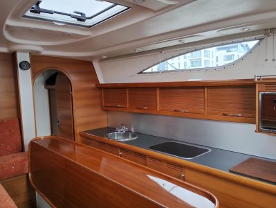

One of my main cabin windows started dripping after 14 years. It's held in with Moonlight frames on each side pulled together with one hundred and umpteen screws with butyl rubber sealant between the frames, the hull and the window. Being butyl rubber it never sets hard so once all the screws had been removed a bit of levering and the frames came off easily. Even old butyl rubber is dissolved by white spirit so cleaning the frames, hull and window was an easy, if gooey, job to do. After cleaning everything was degreased with acetone. Replacement butyl rubber strip is available on ebay for about a fiver and is simple to unroll into the frames before reassembly. Then came the one hundred and umpteen screws to replace and tighten around the frame a few times. Final job was cut off the squeezed out sealant with a penknife. The whole job took a single warm summer's evening and the window hasn't leaked again.
Meanwhile, a friend has a similar aged Beneteau with bonded in windows. The bonding is failing and there are drips. A boatyard refused to quote because they say that there is a high chance that the window will break when removing it. Beneteau no longer supplies a replacement. A bespoke glass forming company has quoted thousands for a replacement. He's unsuccessfully bodged some sealant around the outside which looks a mess and lives with the drip.
Whether bonded windows are safe compared to bolted windows or not I don't know so I'm not going to comment on that. However, I know which construction technique I prefer to have on my boat and live with as both the boat and I get older.
It was that long narrow eye-shaped one...
In my biased and ignorant opinion on-going maintenance of windows, some of which will inevitably leak as boats get older, is a much more important issue than the safety or not of bonded in windows. From a sample size of one of either type bolted in are easy and cheap to maintain and fix by the average boat owning bodger whereas bonded in are difficult to the point of even a boatyard refusing, and have the risk of being very expensive. The idea that the owner of boats with bonded in windows will rip them out every ten years to replace the bonding because that's what Sika say is the lifetime of their goop is, frankly, ridiculous. We all know that will never happen.

2) It's low cost and easy for the builder. A tube of sealant is a tenner and no difficulty getting the installation right in a warm dry factory. A custom designed pair of Moonlight frames like in my photo above costs €100's a set when only a few to a few dozen are ordered a year by the builder.
