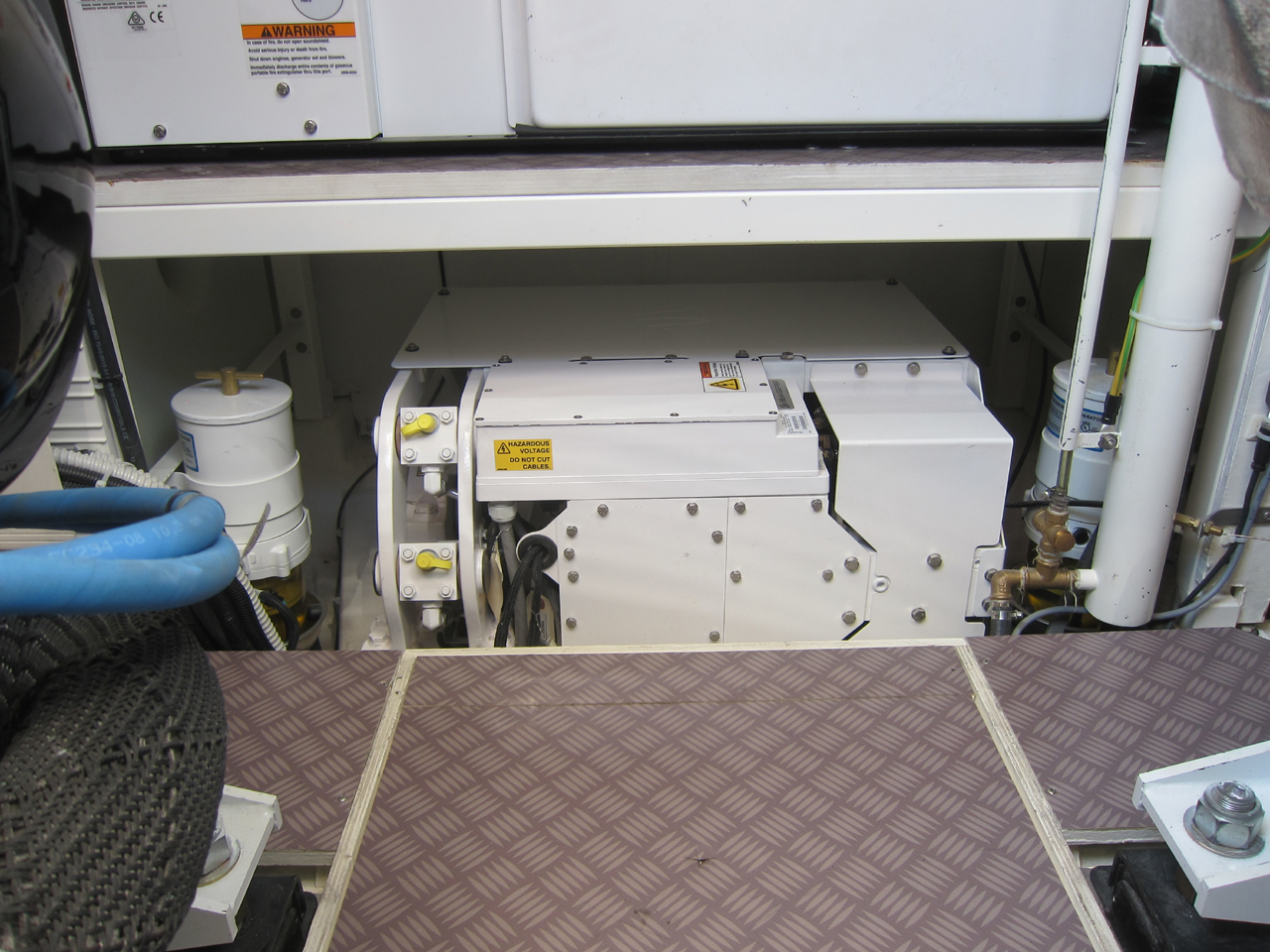

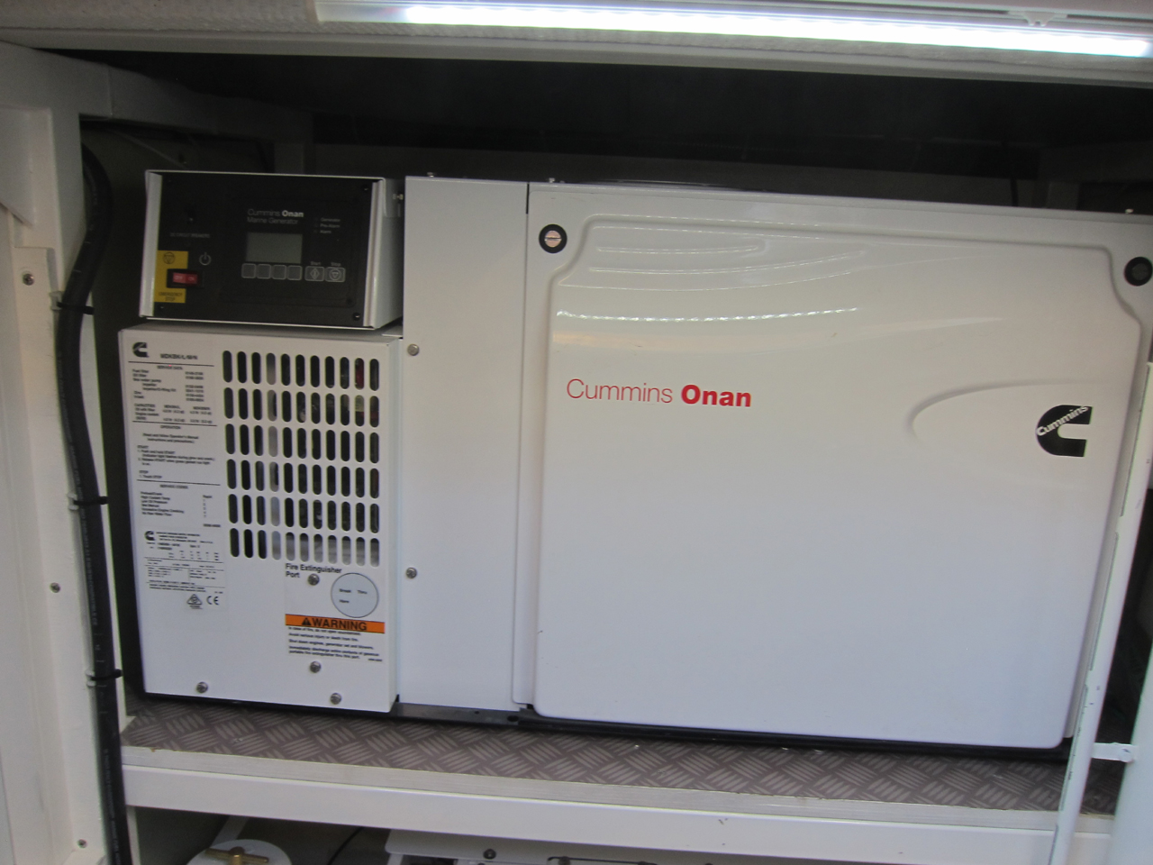

I don't remember seeing jack shafts, I'm sure the v-drives were attached to engine. No sign of stern glands but I didn't spend much time looking, it was 28C outside and much warmer down there.
I think I found the tanks, what's your definition of side tanks?
Hose to left of generator, disappears top left.

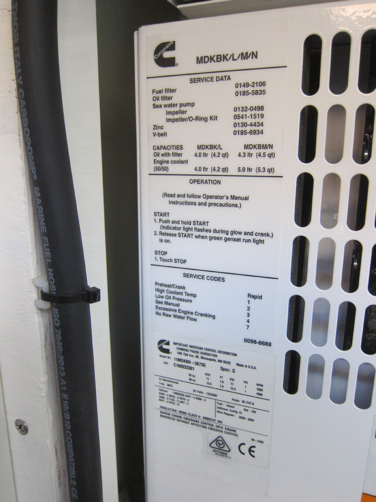

This photo shows it's fuel hose

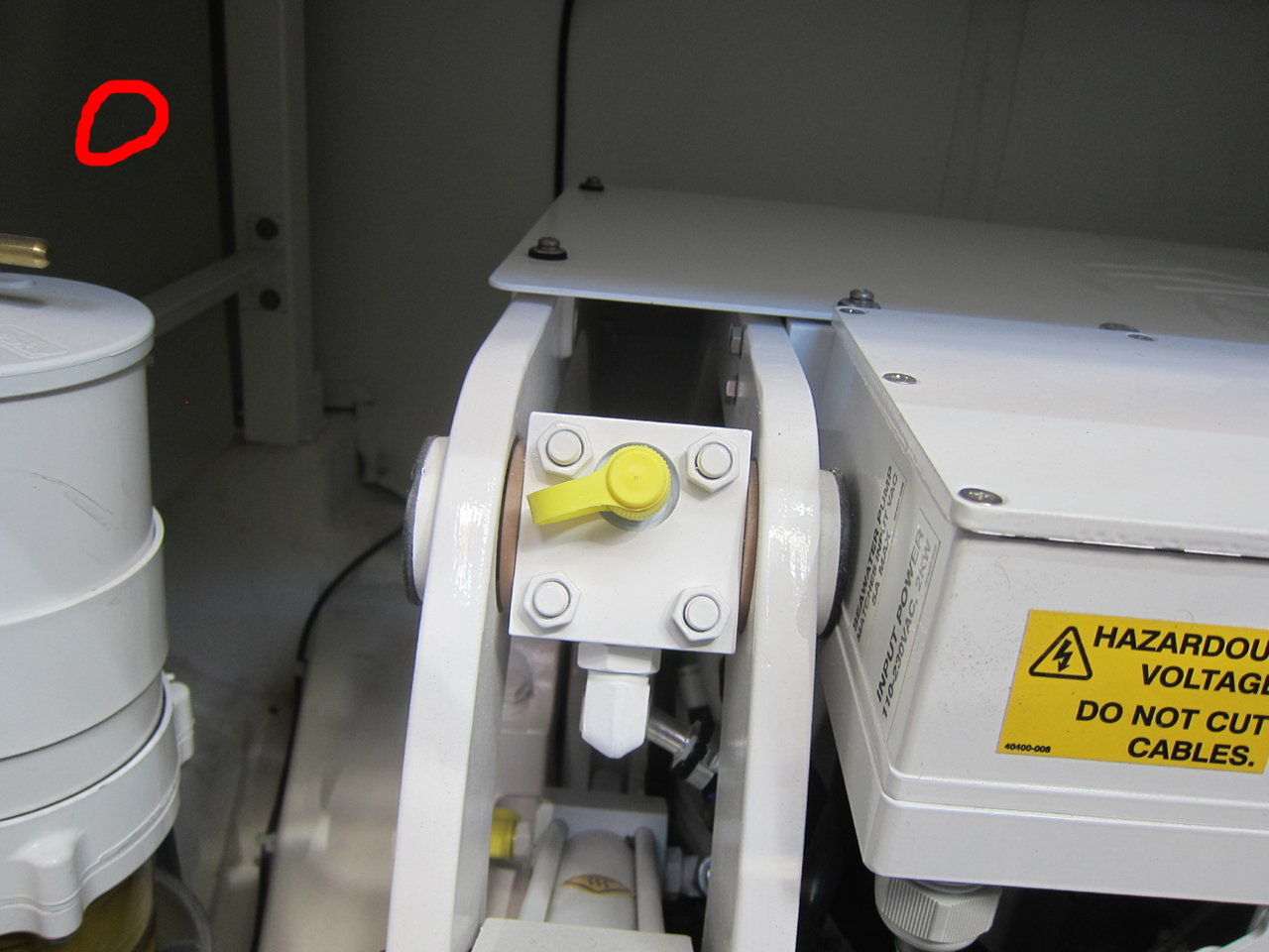

I recon this is the port tank?

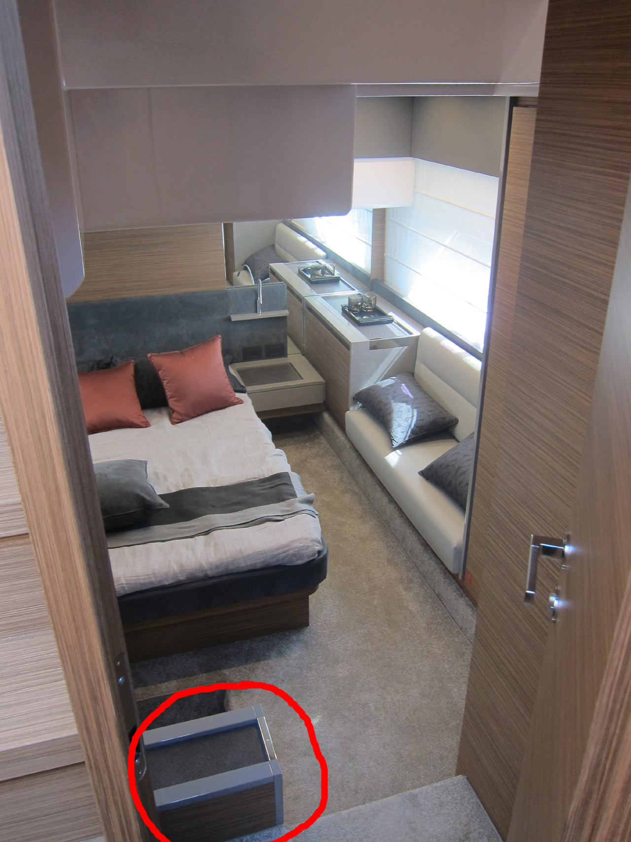

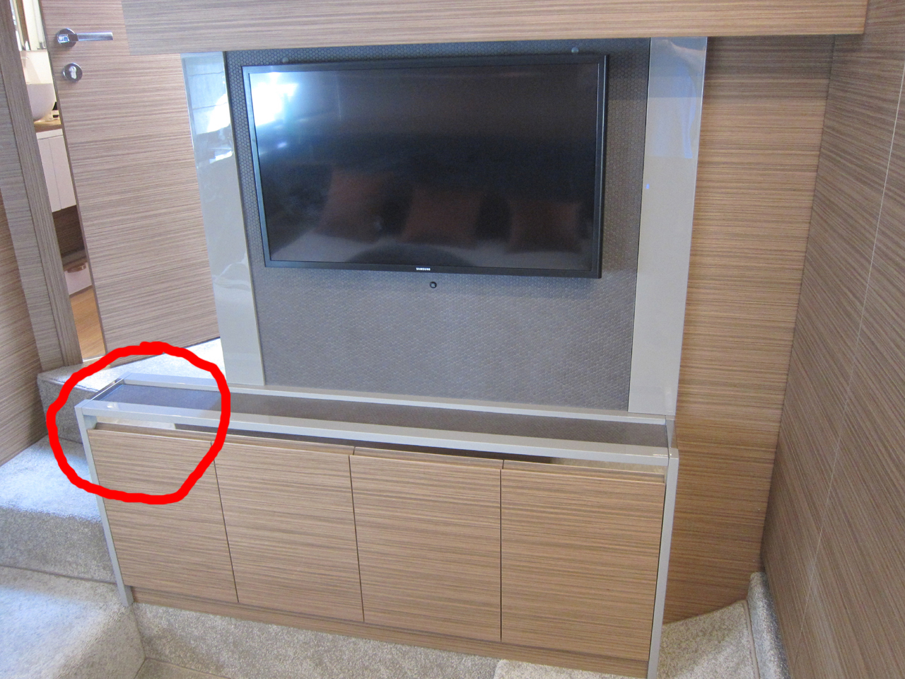

And some constructive criticism on master cabin, not keen on the 4th storage cabinet? Why not have three cabinets and finish at the edge of TV area? Perhaps so people don't walk off the step in to the recessed area in front of the TV?
View in to cabin, you don't trip over it but it looks strange

Sorry, maybe there is a more appropriate definition for them, anyway I meant tanks placed on the external sides of the engines, along the hull sides.
Ref the storage cabin, judging from your pics I would think that your guess is correct.
Not the finest bit of boat interior design I've ever seen, TBH...

Yup that 4 th cabinet is daft -easy op out ??

Yup it seems purpose designed to trip you up before you fall down into the well behind it. One can only hope that this was a pre production prototype that was exhibited at the show. I don't really understand why there is that well in front of the bed anyway. If there is sufficient headroom at the higher level either side of the bed why didn't they carry the same floor level across in front of the bed unless there is some obstruction on the ceiling that we can't see?
The ceiling is not the same height around the bed. The headroom at the side of the bed is achieved by using the dead space under the saloon seating, very cleverly done. But that does mean the end of the bed has lower ceiling, but the recess in the floor does mean you can walk around the bed without ducking under it.
M, actually in the last of the above pics you can glimpse a lowered ceiling right above the "well".
I suspect that's because they adopted the usual trick of raising the ceiling along the bed sides using the saloon seating area, but obviously they couldn't raise the saloon floor centrally, in front of the stair going down to the cabins area.
And if my guess is correct, it implies that anyone sleeping on stbd side in the master cabin has to go down the "well" and up again to reach his/her side of the bed.
'Fiuaskme, I'd rather live without a center cabin than accept this sort of compromises, period. :disgust:
Maybe that's a must for newcomers to boating in the People's Republic, what do I know...?
I got a phone call while writing my previous post, and didn't see yours before posting mine.
That's exactly what I suspected, but I'm not sure to agree with your "cleverly done" bit.
It's already an old trick by now, already seen in other boats, and it's not without its drawbacks.
But as I said, each to their own!
PS: I wouldn't agree on the seating "dead space", either. Back in the days when designers aimed at exploiting all onboard space to the max regardless of what was fashionable, those would have obviously been lockers. If I would tell my swmbo that she can't use anymore all the space under the sofa, her reply wouldn't be polite, no matter how larger the cabin can be....

Ah OK. Then they need to think of some other design for those storage cupboards. Maybe design the end to be curved with a handrail on top?
