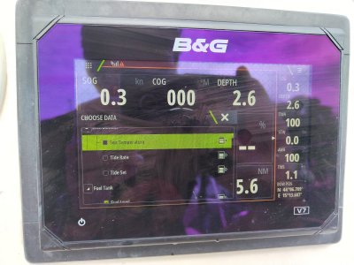

Update: (hopefully useful for those who may consider this)image.jpg
Today I successfully displayed engine data on my B&G Vulcan 7, after connecting the Volvo NMEA adapter to the engine's MDI.
I'm not sure if all the data fields will function, but at least I have tacho, temp, engine hours, alternator volts (this pic is with the engine not running).

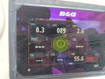

So i managed to put the data field but in the menu it only has the fuel and the oil. There is no engine rpm or engine temp. Maybe when i connect something like that it will show it.
What analogue sensors have you connected to the AlbaCombi ?
Have you connect it to a laptop and configured it ?

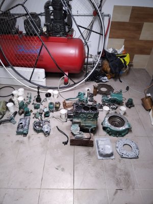

Not yet my engine is in parts so i will take few sensors and try to configure them and then connet all to the vulcan7. My engine now
