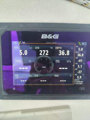

So finaly i have managed to connect the albacombi to the b and g vulcan 7. The rpm where not a problem it is just a signal from the alternator but the temp and oil pressure is tricky. You need to know the resistances for every value. Now that i have did this i am wondering is it possible to connect the raymarine st2000+ tiller pillot to the b and g and stear via vulcan7
This is not possible.

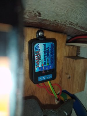

I have bought yakbak comunicator that connects tiller pillot to wifi and opencpn software but never managed to connect it
