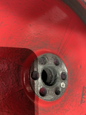

I hope it is OK for you but I would not have countenanced using that crank or the flywheel.
I have a horrible feeling that the surface damage was there when the engine was built, well before the flywheel fell off. What was the mating face on the flywheel like?

Sorry, but as an engineer I would not use that flywheel or crank and I am amazed that anyone with engineering knowledge would.
I do not see how they could accept the elongated holes, the torn threads or the damaged mating surfaces and centre locating spigot damage.
Does the flywheel run true?
Measured at 4 places a gap to a fixed point are 18thou, 22thou, 36thou and 29 thou
So not sure what to make of that

As an update, the engine has run for 15 hours with no problems, the engine supplier has agreed a replacement engine should one be required as a result of the flywheel bolt fail. We have agreed to review options in three months and between us take a decision as to the best course of action.
Many thanks to everyone who contributed
Without knowing what the usual run-out is at that point on an undamaged engine the measurement doesn't reveal much, there's no particular need to have a flywheel precisely machined as long as it is dynamically balanced, probably along with the crank. 18 thou is a bit less than half a millimetre.
