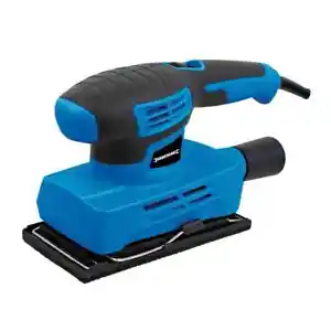

Not suggesting you copy me but this is what I have just done:
Dry is not recommended as above, I did some as there was a bloody great wind and a deserted yard, even so you get covered in dust, it gets into your eyelids and for a few days you look like David Bowie The rest I did wet or semi-wet using a 15 quid sander:
..... plus drywall sanding mesh.
I scraped the loose stuff off first and then used the wetted mesh, worked ok. Trick is to clean the clogged mesh into a bucket of water with a washing up type brush and keep the water on the platten as much as possible and away from the body of the machine. If you use the same bucket you can save the planet by leaving it to settle, drawing off the water from the top and then disposing of the paste residue that is left behind. Ditto if you use some sort of groundsheet you can brush up the bits from your initial scrape.
Those sanders are double insulated so, in theory, you should be safe but I am not sure that even I would trust my own advice on electricity. FWIW I was also using a cheap 850 watt generator. The RCD I had kept falling out of the plug so was largely useless and I am not even sure if it gives any additional protection anyway, experts may comment.
It worked ok but doing it by hand does as well, just a bit slower and harder work. Bear in mind that I was just flatting off not trying to remove all back to a bare hull
I Take the sander apart after use and spray the bearings with WD40 or they seize.
penberth3
9 Jun 2017
3,813
No, don't!!! Dangerously wrong advice. "Double Insulated" refers to electrical insulation only. Nothing at all to do with water resistance. See the ventilation slots in the photo?
