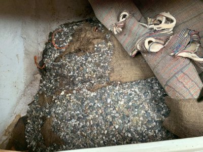

Shortly I will be taking out the gravel ballast in the bow to replace it with something a bit more dense and less likely to hold moisture in it, the gravel smells a bit, but feels dry, and the jute sacks it used to be in have rotted through :(
