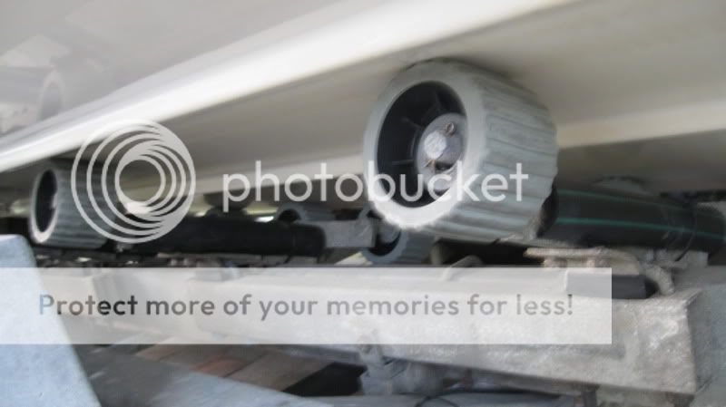

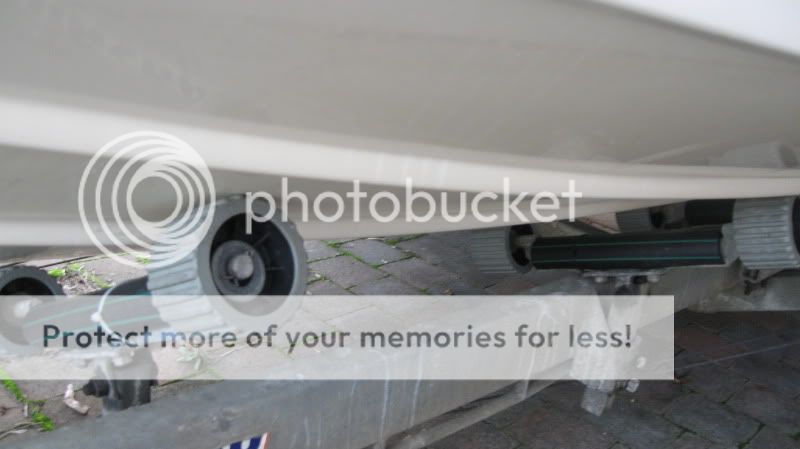

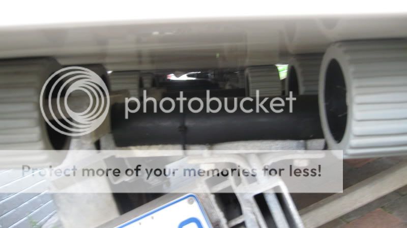

As far as making inexpensive modifications to basic trailers are concerned, I have seen successful outcomes from brackets made up from 2 inch galvanised tube encased with polyethylene pipe.
Even poly pipe (50mm or 2 inch), cut to length and fitted over the steel bracket that runs between the rollers on a multi-roller set-up, assists the boat to slide nicely down into a centred position. The poly also protects the keel and stem gelcoat from impact damage when driving on the trailer.
With a small hand saw, cut a 3/4 inch wide slit, full length of the already cut and measured (usually 280mm - 300mm, up to 12 inch) poly pipe. Spread and jam fit over the multi-roller bracket, then secure with 2 large cable ties. Cheap as chips, works well and lasts forever.
Hi Andie. Great thread and pics. Any chance you have pic of above quote... I just can't picture it?
