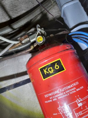

I,m sorting out some issues for next season amd this is one of them .

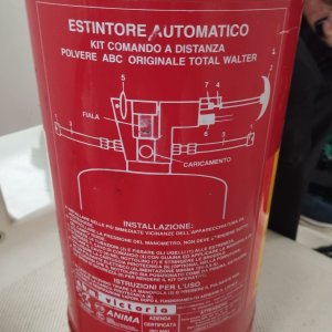

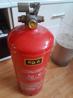

Anybody of you having experience with this type of italian powder extinquisher ? ( installed on a gobbi 375sc )
Its an automatic ( thermal ) and manual pull system where i need to refill the bottle .
The manual pull cable was screwed with a spring into the discharge valve
-does the valve mechanism should stay attached or unscrewed from the bottle ?
-when the cable is pulled out , does it mean the discharge valve is open ?
Thanks for any information !

I would replace it.
As it has lost pressure, it must have a leak somewhere or been set off. Also how old is it ?
As old as the boat probably . 2001 .
I might indeed go for a replacement of the bottle . The system looks not bad . There is a remote piping from the bottle and nozzles directly aiming on both engines and a third nozzle aiming on the generator .
Sure i will also need a new remote discharging distributor in this case . Hopefully the existing linkage from the cockpit cam be used .

Replace is my intuitive feeling.
Maybe look at Stat-X - standalone canister(s) in the engine room - the only maintenance is replace every 5 years - Marine Fire Safety is a good company - no affiliation but have dealt with them commercially over the years

Agree. You also have to ask if it's actually necessary on a 38ft sport boat, such as the OPs.
I think i'd take the existing system out and fit something like one of these ; (for example) :

I think you're into Pressure Vessel/System Regulations, and 25 year old cylinders will cause a few problems. I'd replace it.
You're now talking about a complete system, I suggest that's something for a professional to deal with.
