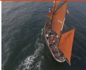

I once spent a few days in Excelsior, a 76-feet long Lowestoft fishing smack. She was tiller steered and wasn't heavy to steer.
I don't know why her designer/builder didn't feel it necessary to fit her with wheel steering. It can't have been an objection to machinery since she was fitted with a steam driven capstan.
Tiller steering was also commonly found in the sailing pilot cutters of the Bristol Chaneel and elsewhere.
Perhaps the attitude of working seamen was simply - why fit something when you don't need it?

Thames barges too. Perhaps it has come to pass that Gentlemen steer with a wheel.
