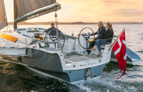

Depends on the type of sailing you do, but generally, I don't like single small steering wheels.
You can only sit or stand behind it like you are driving a bus.
A big wheel is nice is some circumstances, you can sit behind it or alongside it to windward or leeward.
I guess for a cruising boat, a 7ft wheel that intrudes in the aft cabin might not be ideal, so a twin wheel set up is more practical.
Tiller is nice, but going astern in a big boat with a tiller can be amusing.
Wheel, twin wheels or tiller is only only factor in whether a boat is easy to sail. Can you sit somewhere comfortable, helm ther boat and see what you need to? Can you trim the jib from the helm? Can you reach any instruments you want? Can you steer with your foot if you want both hands free for a moment?
If a boat is designed to be raced with 10 people, it's OK for the helm not to be able to reach some controls.
Not so much on a cruising boat.

A fat a$$ed modern boat with a wide aft cockpit and a normal sized wheel on the centreline would be unusable.... it would be impossible to sit outboard of the cockpit and steer unless fortunate enough to have arms like an orangutan.

And twin wheels make it easier to access the bathing platform, and for going ashore from the cockpit when moored stern to.

...... Wheels are mostly about fashion and ego til the thing is 50ft plus.
I'm calling bollox on this ;) .... wheels are primarily practical. They are more compact in use than a tiller, taking up far less longitudinal space in the cockpit. Wheels also lend themselves far better to control by an auto-pilot on a cruising boat as a wheels movement is always constrained within its already occupied space, only being able to rotate, whereas a tiller will sweep the cockpit spilling drinks and knocking over small children. .... and tillerpilots are pants compared to a below-deck autopilot. So IMO wheels are simply a practical solution to the many drawbacks of tillers.
If a particular boater prefers tillers then "fill yer boots", I don't care, my sailing dinghy has a tiller and it is simple and easy to use, some big race boats have tillers so there must be a market for them.
I've got a tiller for my AWB, but it lives in a locker and only comes out in emergencies should the wheels break - which in the last 25 years I have yet to experience.
EDIT: Are you upset because the newer Dragonfly 32 has a wheel and the Dragonfly 40 has two? Wonder why they did that?
