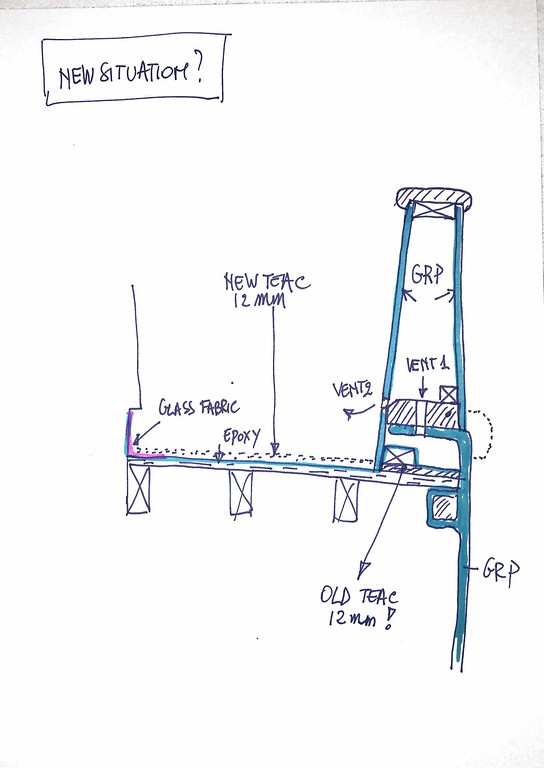

Here some quick drawings to discuss this in detail
1) Re. Ventilation of the gunwale sections
most of you agree that it would be better to vent and drain that space, instead of making airtight compartments,
I considered 2 possible way’s to do that:
• VENT 1 , Drill holes through that mahony beam, (2 holes in each segment)
remember that the cavity just above the deck, is open to the air and water can go out, via 2 scuppers
the longest distance from a gunwale segment to a scupper (air opening) is approx 4meter
And - Or
• VENT 2 Make small slot openings in the GRP gunwale panels , right along/above this "trincarino" beam, so that when water gets in, it has a way out, and can’t stagnate inside.
similar to the openings I made in the old plywood panels, and wich resulted in completely dry inside gunwale… !
would Vent 1 be sufficient, or is Vent 2 the better solution ??

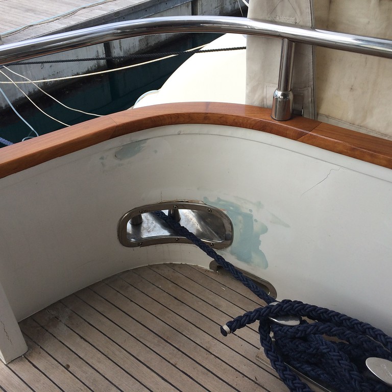

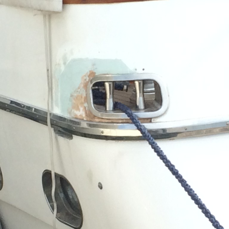

on the side decks, on each side of the boat are 4 x Scuppers,
I believe that's how the deck water draining openings through the bulwark are called ...
= opening in the inner and outer GRP panel, 20cm long, 5cm high, just above deck level
here on this picture is such a scupper right behind the rope
on this picture you can see the scupper opening on the outside
on the side decks, on each side of the boat are 4 x Scubbers,
Aha, that makes sense (fyi spelling is 'scuppers').

Overall, I believe that your "new situation" scheme makes sense, and on top of being the easiest solution without making radical changes to the construction, it's also the best from an aesthetical viewpoint - something which might not be so important on a Malahide or an Azzurro, but on a vessel like BA is indeed relevant.
Careful with the vents, though.
Remember, they must always be placed in the lowest possible point, because what you want to avoid like the plague are puddle traps - even the smallest ones. That's the reason why, in your drawing, I would modify the vents positions as follows.
"Vent 2" is actually akin to the existing scuppers in your pics, and imho it's sufficient to have them on the external sides, assuming that the transversal deck surface is slightly angled downward from the centerline to the sides.
Besides, careful also with their longitudinal placement: in most boats, the deck is not horizontal, but has a slight upward angle from the stern to the bow. If that is the case also with BA, both Vent 1 and 2 should be placed in each corner with the vertical beams towards the stern of all "boxed" sections of the bulwark.

good idea about the external vent openings P, I like that
one small slot opening H x L 1cm x 5cm in the corner, just in front of each GRP frame, and right level with the old teak
there are less deck level GRP frames then wooden upper gunwale frames (scalmotti) see pic below

Bart, it certainly sounds like your hull topsides above the chine are balsa cored.
Hence I would suggest that you invest in a moisture meter and take measurements in various places (perhaps in a grid pattern?) on your topsides when the boat is next hauled out for maintenance (or is she ashore now)?
The odds are that you will find pockets with locally high readings where rainwater has seeped in, from whatever sources.
I have had a Tramex Skipper moisture meter for the past 20 years, and it is brilliant.
Moisture meters are also very good for inspecting balsa cored decks (provided that they do not have teak on top of them) - I have often found locally high readings (going off the scale even) in way of where fittings have been through bolted, and the sealant underneath the fitting has deteriorated, allowing water to seep in to the bolt holes.
